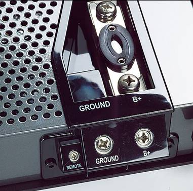

Silver Member Username: Rob_pregYoungstown, Ohio United states Post Number: 628 Registered: Sep-05 | so do you guys see a problem with rockford putting an anl fuse right before the power input on their power series amps? same concept... ![]() |
Gold Member Username: BlainewPost Number: 1527 Registered: Nov-05 | its not actually the same concept...... they put a fuse their so that they could control how much goes into their amp. putting two fuses on you power line is pointless.... when one breaks NO power will go to the other... i see why you would think to put two... your in line fuse should be close to those that are IN you amp. having two fuses on a power wire is like having 3, or 4. or 5...... now if im totaly wrong...correct me..it just seems that two fuses are unneccesary |
