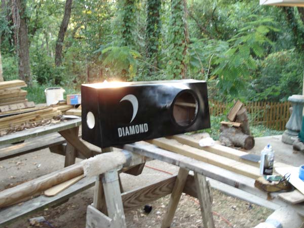

Silver Member Username: RiskybPost Number: 159 Registered: Feb-06 | It's really not as hard as some people make it out to be. For starters you don't NEED: a fiberglass suit (you can just use gloves) a 'good quality' respirator(just do it in a well ventilated area like outside) a belt or disc sander (helps out alot but you could do it by hand if you had to) As far as time goes you could do it in a weekend if you worked on it 9 to 5 both days easily. All depends on how intricate of a design your using. Generally fiberglass enclosures are sealed because calculating the volume of designs with curves is difficult. However, the one I built for myself is ported. I got a rough measurement of the volume by filling it with foam packing peanuts. I think as far as taking alot of practice goes thats pretty subjective. If you read alot on it and take your time and not half @ss the steps to building it I don't think it's very hard. Think about it awhile before you begin to build it. Measure twice and cut once. Here is a tutorial: http://web.njit.edu/~cas1383/proj/main/ Another very important thing is that this project will not be cheap. If you want a decent one I would say budget about 120$. If you want to go all out It will cost even more than that. This is what I paid for my materials at an automotive supply store Two Fiberglass packages 27$ A gallon of Marine grade resin 20$ A 4' X 8' sheet of MDF 20$ 5/8'' wooden dowels 8$ A yard of Stretchy polyester fabric 16$ Duplicolor paint 14$ High build primer 14$ Sandpaper 25$ There were other things like staples a few wood screws and some silicone caulk but I already had that sitting around. My project turned out cheaper because I didnt buy car paint and clear coat that you spray on with a gun. Rattle can paints work fine but if you want to go all out that car paint is going to be another 80$ or so. My finished project 1rst time: ![]() |
Gold Member Username: RzarectorCoquitlam, Bc Canada Post Number: 1304 Registered: Dec-04 | well that box is mostly constructed of wood.. not to knock the box it looks good.. but a fully fibreglass box moulded to an area of your car can get pretty complexe.. mounting of the ring where you cut the base mould will all change the shape.. applying the fibreglass to round edges and corners can be frusterating sometimes as your always trying to get rid of air bubbles |
