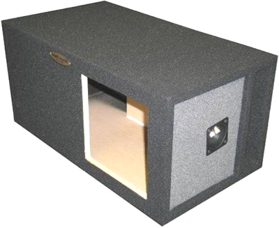

I had a box built for two ten inch kicker l7
I got a ported box the port was on the side only one side it seems the box is made just like this one pictured. I know they didnt order it because they built it the same day. But is it normal for a ported box to have the subs in the same chamber as each other and just one port. If i putmy hand through the port I can touch the magnet on one of the subs. The sub closest to the port opening is has wood behind it. I found this pic of this box on woofersetc and it looks like it is laid out the same. I know the some are in the same chamber. Im thinking if these subs were in seperate chambers ported it would be much louder. Please let me know what you guys think asap. I think this shop screwed me on my install because i didnt buy the subs and amps or componets from them. Let me know asap.Upload

I have a ported box,They sound awesome. But My two tens are in seperate chambers.

If the box is tuned appropriately this is fine. Some manufacturers even release prefab boxes like this.

I would ask them what it is tuned to...
see this specs look at kpl10d
KICKER - L7/L5 Ported
KPL12DC
With larger air volume the KPL Series are built to L7, L5 recommendations between Street Bass and SPL specs. Dual sub versions individually chambered.
Model # Total Openings Port Area Port Depth fb / f3 W H
Cu.Ft. Available
KPL10S 2.18 1 - 10" 15 sq" 9 3/4 43 / 30 23 3/4 13 1/4
KPL10D 4.00 2 - 10" 13 sq" x 2 9 1/2 42 / 29 34 3/4 15
KPL12S 3.00 1 - 12" 27 sq" 12 43 / 29 26 15
KPL12D 5.51 2 - 12" 21 sq" x 2 10 1/2 42 / 29 35 17
KPL15S 5.63 1 - 15" 43 sq" 14 36 / 27 35 17
KPL15D 5.62 2 - 15" 23 sq" x 2 19 1/2 42 / 36 35 17
Note: Net Cubic Feet Less Port Displacement ONLY!

My concearn was my lack of knowledge. I have only saw ported boxes that contain multiple subs each sub have its own chamber and port. They built the medium box straight from kickers specs I was told

I would just think that each sub would need a seperate chamber.

a medium box, i do not know, what are the deminsions of that box
