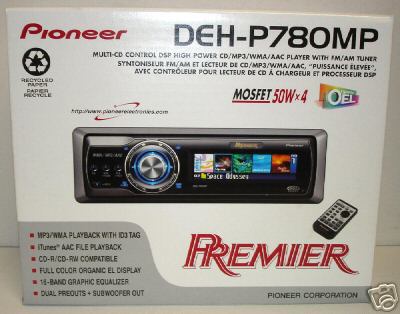

Well guys i finally went with this purchase what do you think.

Great HU...you should've went with the newer iPod adapter though (CD-IB100II)...it's faster than the older one and was made for the 2006 model HU's.

Interesting how much faster is the newer one ? & will it really make a difference ?
Also do i need some type of wire to connect the console to the Head Unit ?

That should work out well for you, the 780 is a nice deck.
The control module should come with the wire you need to run it to the deck.
The CD-IB100ii may be bit faster in terms of track access, but as far as it making a difference that'll depend on what you think. If you get the CD-IB100 and can't stand how long it's taking to change tracks and what not then you may want to look into the '06 model but, from my experience even the CD-IB100ii just takes way too long. And since you HAVE to control it through the deck I still stand by the AUX in method as being the most efficient.
