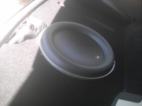

Get a box like this, to drop down into your cargo area. :-) (this one is the one I have in my 1999 Firebird, it's a 13W7)
Username: Camarobump
Post Number: 36
That looks really good, see my 2 infinities were facing just like that, so that must be the best way to face the sub, how much did that sub cost?

The box costs around $300 to have built. It actually takes up the entire cargo area, where you normally store T-Tops, though. So have a different plan for those - if you're going to have your box like that.
You can have those made for two 12's, one 15, or three 10's. at Subthump.com They used to make ported styles too, but dont seem to anymore. They also make boxes where you can still store your t-tops.
