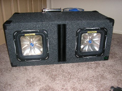

Dan finally got that new box going. Putting it in the car today... Did u get any picks of your installation up yet?
Username: Spidercoder
Post Number: 48
no net yet i will today though. i did go with a ported box though. Just one vent on side

looks nice

Wow i cant believe the difference this box makes. The bass is insanely loud and it sounds good. Makes me not even want to buy the new amp. But with my personality i am only satisfied for such a little time, so i will buy it anyway. But i cant imagine these subs hitting any harder then they are now!
