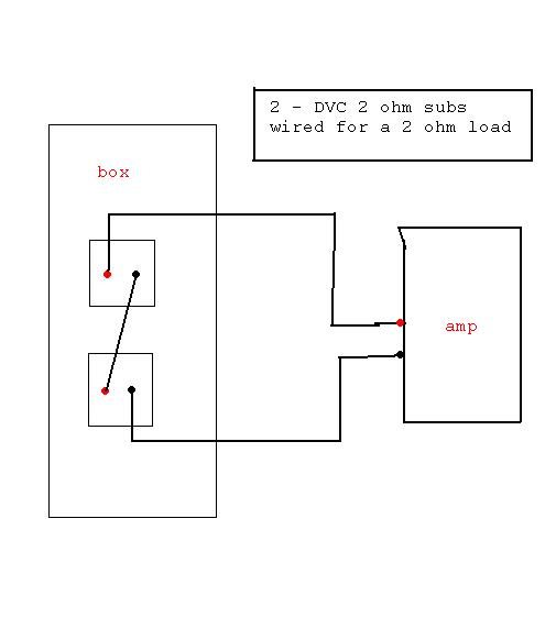

Silver Member Username: Van_manBoston South, MA Post Number: 855 Registered: Mar-06 | ![]() |
Gold Member Username: Basshead86Google is your Friend, FL Post Number: 4767 Registered: Aug-05 | once again. NICE CHART!!! |
Silver Member Username: Van_manBoston South, MA Post Number: 857 Registered: Mar-06 | You need to wire both sides like this. ^^Thanks^^ ![]() |
Silver Member Username: Cplaya280Quakertown, PA USA Post Number: 292 Registered: Oct-05 | alright thanks everybody i found out it was wired incorrect so i wired it up correctly now and it sounds amazing |
