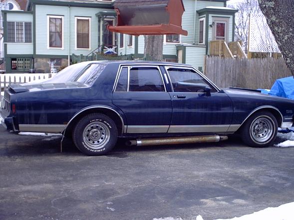

Silver Member Username: Van_manBoston South, MA Post Number: 862 Registered: Mar-06 | This was the car it was in ![]() |
Platinum Member Username: GlasswolfWisteria, Lane USA Post Number: 11600 Registered: Dec-03 | because with an automatic transmission you don't *need* a tach. pretty to look at though I suppose. Only reason I have one is for dragracing, since my auto trans has a manual valve body, and I can manually shift it through a sequential gearbox. |
Silver Member Username: Van_manBoston South, MA Post Number: 863 Registered: Mar-06 | Ya, mine was just for show. I had put in a B&M Starshifter, so it was good to watch it max out @5500 rpm. But for raceing, its a must. Nice car by the way GlassWolf. |
