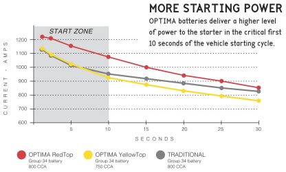

It's true, I've seen a lot of people buying yellow tops for no reason, even Optima has a chart showing that you get more current from a red top (and even a traditional battery, though I think they manipulated the tradtional battery specs in their favor):
