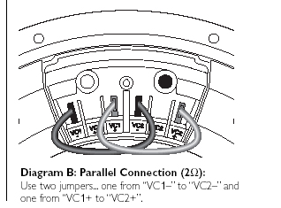

According to the user's manual online(http://mobile.jlaudio.com/pdfs/7876.pdf):
quote:
Use two jumpers...one from VC1 to VC2 and one from VC1+ to VC2+
They have a picture of it in the manual, I highly suggest you look at it, the .pdf itself is hardly 1mb I believe.

The JLw6v2 isn't your run of the mill sub, it has a simple jumper system:
Wire each sub like that. That's all you have to do.
