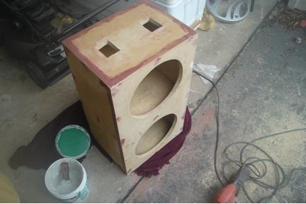

Here is my first attempt at building a subwoofer box for my boat- there's a whole new set of challenges when building for a boat- It has to be able to withstand the elements, it has to be loud enough to overcome the ambient noise, it has to be weatherproof, and in my case, it has to be compact so that it can be hidden. UploadThis is the box after construction- I love my new table saw.
UploadAfter putting on all the wood putty. I found that putty on the end pieces of mdf works great if you plan to paint your box. Otherwise, the paint will soak in and the ends will be obvious. A lot of primers won't even stay on top. I put on two coats of primer. I had the idea of using the same waterproofing primer that you use on masonry to prevent leaks. Made sense to weatherproof the mdf. I sanded with 220 grit after each coat so the surface was nice and smooth for paint. I put two coats of rustoleum gloss white.

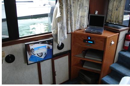

Thanks! I can't wait to hear it at the sandbar. you should see this place in Miami. Hundereds of boats anchor up in like 2' of water, ladies making out, and stereos are always blaring. I am in the process of trying to outdo my friends with their boats. They should have sound competitions just for the water. Here's the rest of my system so far.UploadI built this entertainment center out of oak to fit into an unused corner of the cabin, plus it covers a lot of ugly holes in the walls the boat had when I ot it. I mounted a bottle opener on the side (used frequently lol) and mounted a docking station for my laptop on top. Once I snap my laptop in place, I have full acccess to DVD player, all my music, HDTVB tuner, TIVO, etc. I have cellular wireless so if I don't have a song, I can get it. It also has Karaoke software installed so once I get my wireless mike, you can sing along. I hooked up an FM transmitter I got on EBay and it boradcasts in a 150' diameter so any boats around can listen to the same thing. The housing for the head unit unlatches and swings down to access all the complicated wiring, and the center houses two Coustic amps and right now a Sony home theater subwoofer (just for the cabin- nothing huge needed down there to sund good). I mounted a 19" flat screen on the wall and since this picture was taken I have added a blue LED voltage meter, a 1.5 farad cap, and flanked the flat screen with 2 4" Kenwood coaxials. Up on the bridge I have a pair of 6.5" Clarion marine components and a wired remote to control the head unit from up top.
Here's what it used to look like before the entertainment center

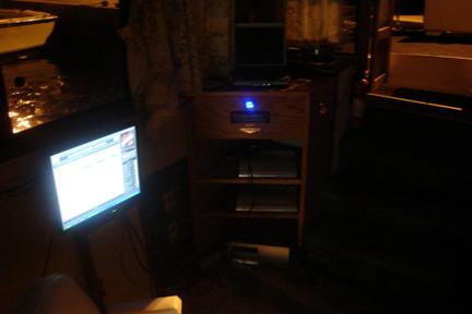

This is the most recent picture, although not a great one. There is a lot of wiring to hide that goes to and from the bridge up top. I'll post more pictures after I tidy things up a bit.

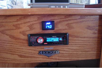

Head Unit- I set the system up so that it can be faded from outside to in as opposed to rear to front. Great if you just want to lock yourself inside and watch a movie.

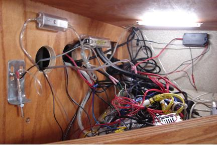

I built this entertainment center to be able to unlatch and give me access to the extensive wiring for the wired remote, usb gadgets, neon lighting, terminal blocks, aux inputs, etc. I know, I know. The wiring's a mess. Every time I needed to add another gadget it went in here and further complicated things. Everything works and I know where everything is, though. Kind of like that guy at work with piles of paper on his desk but still gets things done.

very nice, is that a pioneer deh-580mp HU, looks identical to the one in my car.
Username: Furyous
FL USA
Post Number: 41
It is. Pioneer is the only manufacturer I could find with auxilary in and wired remote capability. This is my second one- my first one developed a loud hum. I'm also kind of bummed that you need to buy a seperate component to accept the auxilary input. Now that things are all connected, I'm happy with the unit. Nice features nd easy to use, plus I like that display with the power meters.
