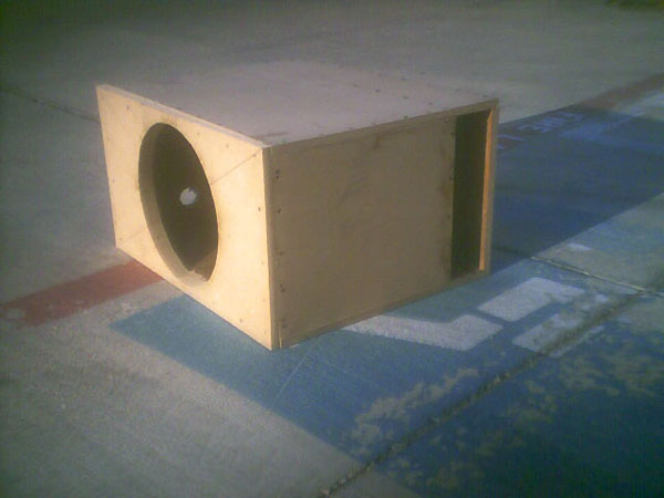

Silver Member Username: FrkkevinLake Worth, Texas US Post Number: 410 Registered: Nov-05 | Well I built a new box to compete with and it turned out to put up lower numbers than my street box. The new one was 4^3ft tuned to 42hz with 54inches of port area. It had a double baffle and was completely glass resined on the inside. The port was at a 90 degree angle to the sub this time instead of beaing in the same plane. I tried every box variation there was and the best number I could hit was a 145.2. The Texas heat does not help by far but for my last run I put in my 4^3ft box tuned to 35hz and hit a 145.3. Yea it was only a 1/10 of a dB louder but it was my last run and at the last comp that box hit 145.7. I figured the new box would put up better numbers being tuned higher and being glass resined. Idk what happened... Better luck next try. Any suggestions? |

Gold Member Username: SouthernrebelMonroe, Louisiana USA Post Number: 3078 Registered: Mar-04 | WTF??? i figured you would do better w/ that 42hz box i helped ya out w/. what freqencies did you play...where did you peak? did you drop your back seats and lean both front seat as far forward as you could? and stick the meter high in the passengers kick panel? |
Silver Member Username: FrkkevinLake Worth, Texas US Post Number: 411 Registered: Nov-05 | the meter was high in the passanger kick panel and accoring to the pc i peaked at50 but my note varried from 47-50.. both back seats were all the way down.. i was sitting in the drivers seat and the front seat was far forward.. idk i was confused. i figured with a higher tuning frequency it would get louder. all the pros there said it was more than likely the placement of the port because the box was built very well. it was funny.. i turned that box like 360 degress and even tried firing the port into the cabin and the sub at a 45 into the corner of the trunk. nothing seemed to work.. this was with the low pass all the way down the high pass all the was up 0 bass boost 3/4 gain and the low pass on my h/u was set to 120hz with 0 bass gain and the subwoofer level was on max. i guess the box just wasn't going to work... but this kinda stuff is al ltrial and error so who knows. so i guess now ima have a box for sale |
Gold Member Username: Basshead86Google is your Friend, FL Post Number: 4599 Registered: Aug-05 | more port area you should've had around 70sq.in. or at least i would have. either way though...that is weird. |

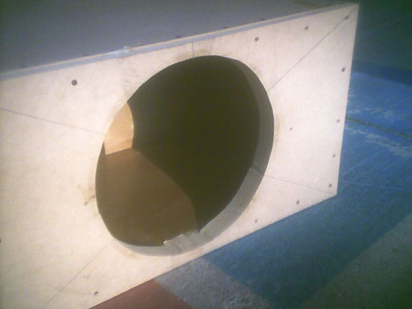

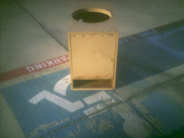

Silver Member Username: FrkkevinLake Worth, Texas US Post Number: 415 Registered: Nov-05 | Theres the box.. going to end up selling it now so anyone whos interesting let me know. It needs a speaker termial connections because I had to use the one that was in it to put back in my other box. |
Gold Member Username: BestmankindLos Angeles, CA USA Post Number: 4780 Registered: Oct-05 | nice looking box man. too bad it didn't do what you want it to do. what kinda car do you have kevin? |
