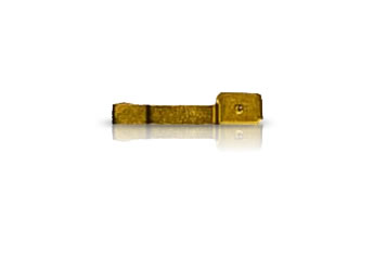

Yeah, just use a fuse tap, and find a fuse that only receives power when the car is on if you don't want a switch. It's the gold tab in this pic: Upload

You need to go to the main fuse panel and find a fuse that only gets power when the car is on.
Then, buy a metal tap for it, as posted in the above picture, and hook it up as shown.
Next, simply connect to the remore wire from the amp to the fuse, and you're done! :-)

Get out your owners manual - find the page(s) covering the accessory fuse panel. Look for the fuse labeled (radio), pull it. Buy a fuse tap as Jexx mentioned - radio shack has them. Install it.
Here's another look...
That will give you a switched source to connect to your amp's remote turn on.
