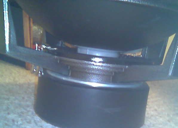

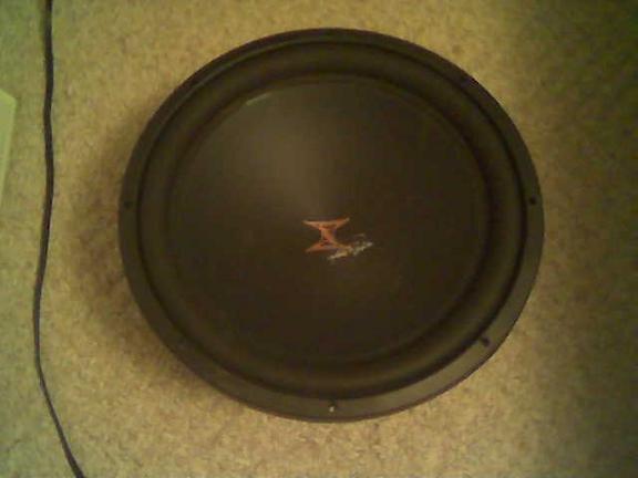

Finnally got my new sub ***PICS***
Username: Adam_s
Post Number: 134
Registered: Aug-04
well I got it today. Took some pics tell me what you guys think. Ohh and the last pic is of the box I plan to build for it tommorrow tell me what you all think of that too....Will it pound in there??

seriously....more pics of the sub....like in your second pic except zoom out more. and use a coke can for reference....get Creative!!!! lol

here ya go...some more pictures...now someone please tell me what they think of the box plan and the reason I am doing it with the pvc ports instead of a slot port is to save space

sorry the pics arent the best they are from my phone cause its all I got to take pics w/
