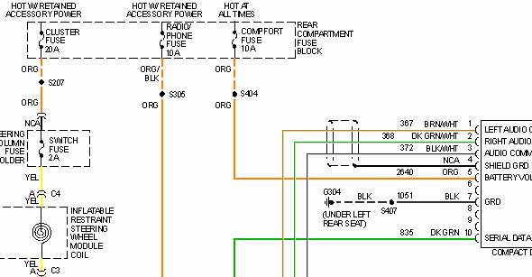

Silver Member Username: LeewKetchikan, ALASKA USA Post Number: 526 Registered: Jan-06 | this the schema,check all of them...it's belongs to one hu!

Silver Member Username: LeewKetchikan, ALASKA USA Post Number: 527 Registered: Jan-06 | Well Dennis,I just checked schema for your cadi and I see where is the problem! It's missing constant 12V ,you got only ACC+12V (orange wire).You have to run constant+12V, straight from fuse box. |
New member Username: BrewerspowerhittersPost Number: 4 Registered: Aug-06 | My wire harness has a constant wire on it. How would the stock radio run then? Also do you think running the 12V Constant and the 12V switched togeather would cause a problem? ANd do I run a wire from any of the fuses? Thanks | ||

Silver Member Username: LeewKetchikan, ALASKA USA Post Number: 531 Registered: Jan-06 | I dont'n see wire, constant+12V, which is coming to HU,only orange B+,but it ACC wire.Const.+12V run from fuses to CD changer. --------------------------------------------- ![]() |

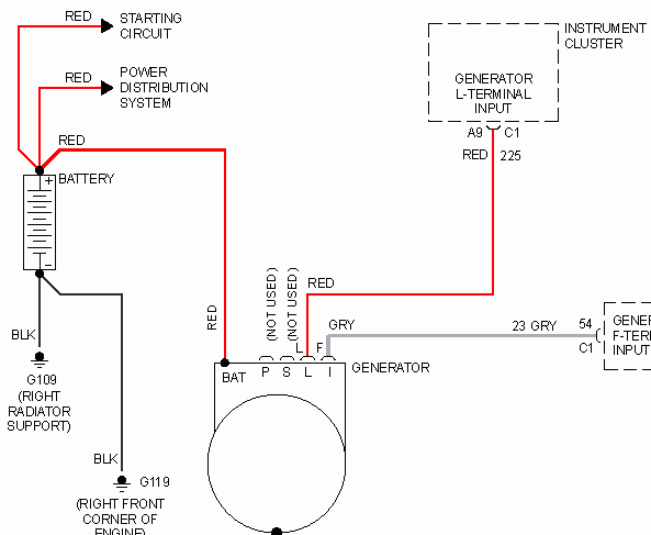

Silver Member Username: LeewKetchikan, ALASKA USA Post Number: 534 Registered: Jan-06 | ok Dennis,the first schema shows which color+ is going out from battery. It's red one,then after a big fuse(the fuse its hide on that pic) it's can be any color(by this pic it's BLACK).Then , another big fuse and it come out red color straight to ignition lock.(you need D5),(second pic). Remove the trim panel from steering column,and find red wire/check it with tester,without key have to be power/,now,make good connection/very important:put fuse inline required by HU manual,close to red wire,That is it,you ready to go.Find good wire,wrap it up with plastic cover(you can get it in Walmart,it special pipe to hide el,wires and all el.clamp) connect your new HU. Dont forget to connect ACC wire. ---------------------------------------- -------------------------------------- ![]() |
