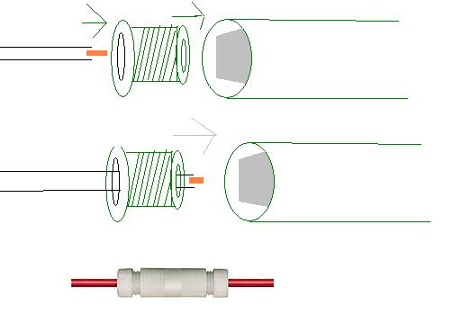

You dont have to crimp those things btw - they screw in at the ends you put the wire through it, then screw it in, and it holds them SUPER tight.

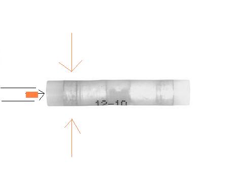

with a butt connector, you have to crimp right there..and still most of the time, I'm able to pull the wire out if I pull hard...with the other type I linked to, I can NOT pull the wire free. :-)

so you basically just plug the wire in?? no need to strip the outer wire off?
Username: Fandim
Reno, Nevada United State...
Post Number: 1297
Registered: Jun-05
you do, just like 1/4th of an inch tops, though. :-) And it holds soo crazy tight, it's very nice. And no need for electrical tape etc like I mentioned earlier, since the outside casing is all plastic.

I use the little orange wire caps to hold my wires together and they wind up taking up alot of room behind the stereo, would these take up less room?
Username: Fandim
Post Number: 1308
Registered: Jun-05
Yes, a lot less room. They're also in-line, meaning you dont have to have a point in the wire where the first wire goes up, and the wire you're attaching goes back down the same path.. easier to draw it out, so here..
