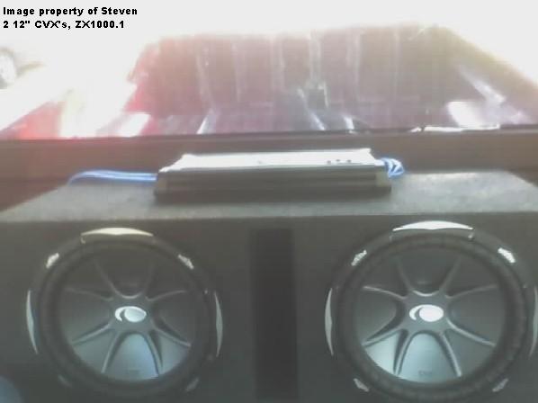

i would use the new cvx
maybe because thats what im running :p

Username: Th3di3s3l28
Post Number: 26
Well, I love them to death. I used to have 2 12" CVR's, and I sold them to get the CVX's. Basically, it's what they tell you, it's a solobarics loudness, with the quality of a round sub. I love them. They get loud as hell. But they sound really good. What amp are you using? I've got a ZX1000.1 putting out almost 1200 watts to them.
Post Number: 28
Not bad. Yeah my birthsheet says 1192 so its around 600 going to each sub. You'll love em. Trust me
