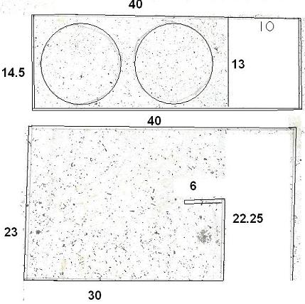

Silver Member Username: Talon_es93Post Number: 316 Registered: Mar-06 | or would this box work better? curent box |
Gold Member Username: James1115Ct Post Number: 6034 Registered: Dec-04 | yup that will work, or you can do 14x14x30, it will give you some more room to account for port on the front baffle. |
Silver Member Username: Talon_es93Post Number: 317 Registered: Mar-06 | u think i can wit a 3" wide por on a 14x14"? |
Gold Member Username: James1115Ct Post Number: 6036 Registered: Dec-04 | yeah why not you are just gonna have to make up the port length in the width which is no big deal. |
