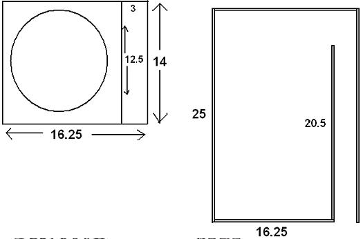

Silver Member Username: Talon_es93Post Number: 298 Registered: Mar-06 | i wanna make a box that 2.25 cu ft....i need it to be 14" tall with the port 12.5" tall and 3" wide and 20.5" long...idk how wide to make it or how deep... this is gunna be for a CVR 12"...this will be using the manual... it says...2.25 cu ft. 63.7L + port displacement 3" x 12.5 port 20.5 long (7.6cm x 31.8cm port, 52.1cm long) power handling=300RMS.......so if anyone can tell me how wide and deep to make it it will help alot...or if you have a nice design for this plz let me know...thanks...(3/4 board will be used)... and also what is the driver displacement for a CVR 12" |

Silver Member Username: Talon_es93Post Number: 300 Registered: Mar-06 | would this work for what i'm tryin to get?? |
Silver Member Username: Talon_es93Post Number: 301 Registered: Mar-06 | http://www.subwoofertools.com/forum/ported-box.asp?Ew=16.25&Eh=14&Dia=6&Xmax=.49 8&Vd=.07&NumW=1&Vb=2.25&Fb=40.745&Qts=&Vas=&Fs=&CE=0 or would this work better? |
