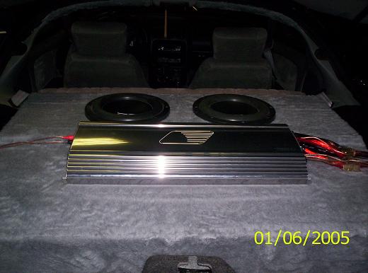

what guage wire for an orion 2500d??

i have that amp
actually it has 2 seperate power supplies & 2+ /2- terminals which only up to 4g will fit so i suggests u get a 0g into 2) 4g distro block ......

rovin, where do i put the distro block
by the amp or by the batt??
Username: Blainew
Post Number: 1293
and to add to that....when the 0 guage splits to 4, do i need an inline fuse in each 4 g wire, and an inline in the 0 g wire

right now its stock only usin 1700W @ 2ohms but my car iam gettin a 200amp ho alt but dont use 0/1 4 the amp part use 0/1 from battery an use 4g from dist. blocks cause its a bi1ch 2 get the 0/1 in there or if u can find sum bananna plugs make it from 0/1 to 4g

that amp only accepts 4g power/ground cable - its even in the manual which i have right here
put distro block near ur amp as possible i suggest
when u begin running ur 0g put 1 200A fuse (thats how much i guestimate it pulls -there r formula online 2 check it though) put this 1st main fuse about 12" away from + terminal , well the distro block will have 2 holders for 2 fuses so each fuse will be 1/2 of main fuse .
This amp pulls serious current so i strongly suggest a HO alt & @ least 1 drycell batt....
