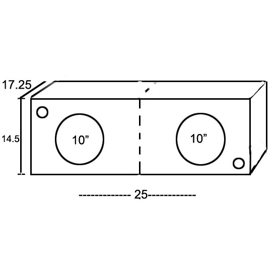

Rovin, Please look at this
Username: Aman2005
Post Number: 150
I've uploaded this pic on the thread we were talking. But don't know why on the main page its not showing. anyways, Please look up at the sketch of the enclosure and tell me if any alteration needed. Also, I have bought a Hifonics Brutus 1000d amp for powering my two Type R's 10" 4 ohm DVC. Will that amp be able to pound the subs?
Also, after installing dynamat or any other noise deadning material in trunk, will the bass be able to surround outside the car? I need a killer system by which I can be recognised and people can know that AMAN'S CAR IS COMING LOL

that amp should be close to perfect for those subs. i cant tell you anything about the box though.
are those holes for like a bandpass, or is it sealed or what?
Username: Aman2005
Post Number: 152
That holes are for port
Username: Rovin
Trinidad & T...
Post Number: 8157
box is waaaaaaaaaay to short cause 25" - 20" of ur sub leaves only 5"
y did u make it soooooo deep ?
Been proven on some thread on ecoustics a while ago that Hif amp actually do about 75% of advertsied power & a type R can easily handle 600wrms each so i'd prolly get the 1905D model instead
u can use a 3" pipe port & put both pipes @ the same level not 1 up 1 down ......

well rovin, that meaurements are give on alpine canada webpage. I've just doubled the width. Any suggestions?
Can you recomend me the measures?
Also, Is that absolutely true for the hifonics? Then why they are very popular on these forums?/

i'd go like 28w 13h 12d but idk what that could calculate to...

4get wat measurements they give u - ur going by BOX VOLUME so ur still doing it right
yep its true on Hif amps - when ppl read this thread they will back me up , its a good econo amp so thats y
im about 2 go work on my own box - so talk 2 me ASAP fast ......

hmmm.. they seem to be for both subs, right?
Username: Aman2005
Post Number: 155
rovin, i found the measurements they suggested are occupying the same volume i.e. 1.3CUFT. IF they are not correct, please suggest me the measurements to make an enclosure
Hope to get measurements from you

other option
on the 12v site - just calculate as if ur doing 1 box but build 2 boxes like what i did . It makes lifting it in/out alot easier .
im leaving now - back later 2 nite ....
Username: Rovin
Trinidad & T...
Post Number: 8161
oh & each sub MUST occupy its own volume space ,
im outta here now .......

look up the type R secs on alpines site, and go from there, calculate and build your box to those spesification. make sure its alpines site, not canada's alpine site

shaine, I've checked the owner's manual of Type R SWR 1042D, those specs are also stated there for the vented box. What Should I DO??

well seeing that usually the ported boxes are usually bigger i'd say something along the lines of 1.5^3 feet each box, which should be around 2592 cubic inches for each woofer 1728=1 cubic foot

make a box look how ever you want it just make sure each box is 2592 cubic inches, that should be the optimal size for a ported box. so each box should make about 12 14 15 about, that should be a good size box for each woofer

You mean i've to decrease the depth. wWell thanks. Will this enclosure, if tunes at 33 hz, be able to pound the subwoofers very hard??

yea, just use the dementions i gave you, FOR THE INSIDE OF THE BOX, so add .75 inches where nesisary, and for the 15inch par, double it and make it 30

Why should the depth be doubled?
If the diemensions are as w x h x d, the 15 is depth.

15 is the width, like how long it is, any way you do it, just put the woofers on the 30inch part lol the demtntions should be 31.5w 13.5d 15.5 high

1.3cuft each is correct for 10" type R - i have my spec sheet here when i bought my Rs mths ago
use - http://www.the12volt.com/caraudio/boxcalcs.asp
& input according 2 ur space
- if a typical box 4 whatever sub requires measurements example 10/15/20 (Height/depth/length) & u need a single box holding both subs then its gonna be 10/15/40 with a separating board in the middle
whats so hard 2 figure out !?.....
