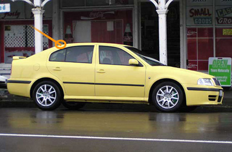

hi nick,
Its a pair, two type r 10 " SWR 1042D 4 ohm. Actuallu I dont know the dimensions of the car. If i place box at back of the rear seat subs facing up. wat will be difference?, I am posting a real pick, hope that may help you. the rounded mark is to let you know that the trunk cover or what it is, opens like the mark shown in the picUpload
