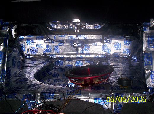

makin the box thursday so u gota wait for the finish box pics ill get them up asap but heres sum pics of b4 trunk an the room i got box will b 8cubes if not more 2 12 cvrs or 2 type rs tuned @ 24hz or 32hz port will b pieced so i can make if 2 diffrent tunes an the subs will have there own chamber Upload

Tight wuts dat stuff?? Dyno??
Username: Scott_debaker
Pittsburgh, P.A. U.S.A.
Post Number: 412
fatmat

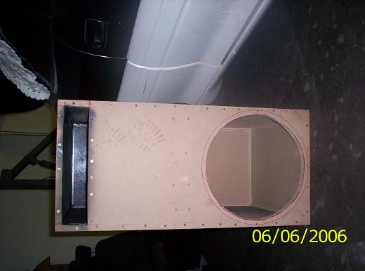

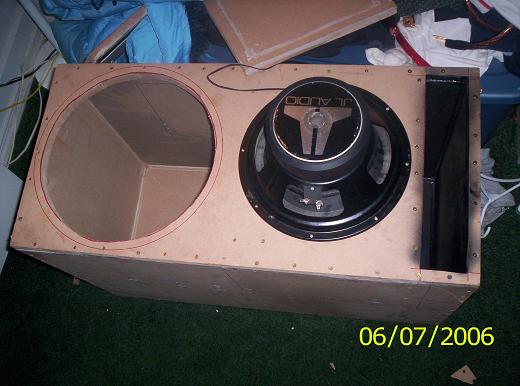

my old box might look small but wow its really huge heres 1 12 on the single 15 boxUpload

Hmmmm, why did you mat the back of the seat? You add mat all the way around you may not get any sound out...Polo. :-)
Post Number: 430
what ya talkin about polo

Did you just build the box to take up as much room as you had in there or did you specifically build it for a sub that you modelled the box for?

iam buildin the box big as i can fit in the trunk i had my trunk open cut out way more so i can fit 34wide an 16high be4 i can only fit a 3.5cuft box in there new box is goin 2 be 16high 34 wide an 32 deapth bigger box sound louder an its goin 2 b 8 sumthin cuft lol

thats not the box i still gota make the 8cube box thats just a 5.25 cuft box an this is all b4 displacments

Sorry, what I meant is the back seat area, it has been totally (from what I can see) matted. You don't want to seal the trunk from the cabin area. What I did was remove the back seat then removed any uneeded metal making for a good flow into the cabin area. All the metal that is left over, cover and then be sure you pop out the breathing holes. I have also removed some of the foam material from behind the seat cushions, has all made a huge difference. Let us know how well that stuff works...Polo.. :-)

Wait, is the view of the trunk from inside the car? If so, NEVER MIND, lol. Polo. :-O

thats fron inside the car retard lol j/p but thats from the inside of the car the box is gonin in right there an subs r goin 2 b facing in where u c the opening thats where the box is goin 2 b firing lol

Try to get a perfect fit in order to seal the cabin from the trunk. Polo..

n polo, yeah I saw that too, but then looked at the pic again and realized thats not the back of the seat, its the back of the car lol.

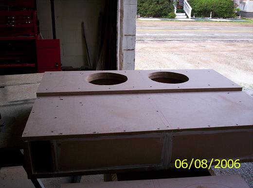

Post Number: 450

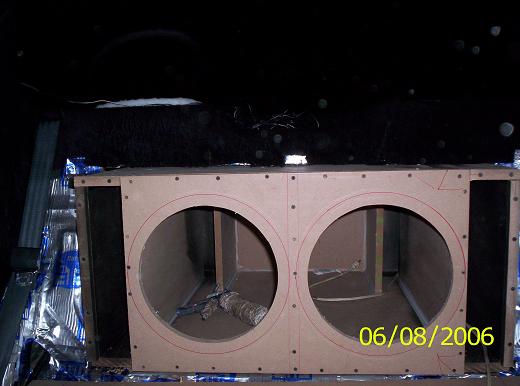

Post Number: 452
16 high 34 wide 32 deapth

its 4.223 each chamber

box is really loud tuned @ 25hz but it kina suxs on the highs it was makin my cell move on a roof of a truck liek 16ft away an flexin the lil window on the bac of the truck lol sounds go0d was only usin 2 12 cvrs off a boss amp it it pounds hard but now i got rattle comin from da gas tank

if i take the 2nd port pieace @ it will b at like 29 or 30hz an the fat mat works go0d will i shut all my doors u hear no bass but now since the kickers where in there gas tank rattles alot lol an it sounds go0d

i bought 200sqft of the fat mat for liek 250 shippd off ebay cant beat that
