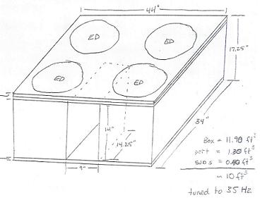

the 4 subs are firing up with the port firing back. the top is going to be double thick and most likely the side with the port as well. 2 support braces in the box...not sure where yet.
box dimensions are 44" wide, 17.25" tall, and 34" deep. all in one shared chamber. 11.90cuft before displacement...right at 10cuft after.
1 huge slot port down the middle thats 9" wide, 14" tall, and 14.25" deep. tuned to 35hz with 126 square inches of port.
on the computer it said between 154-156dB.:-)
not bad for under $2000. haha

interesting - so what programme u used 2 come up with that design ?.......

my local audio store called ED and they worked out some specs for it. i origionally wanted 2 ports but because of width issues in my car we decided that 1 huge one was the way to go.

what program did you use to calculate the dbs?

im not sure the name of it. the audio place did pretty much everything..ill try and find out tho.
