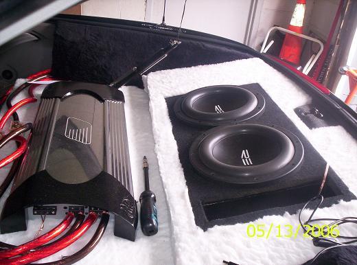

Username: Scott_debaker
Pittsburgh, P.A. U.S.A.
Post Number: 405
Username: Thomas_g
NM
Post Number: 1179
ya nice setup man^^^^^^^^^
Post Number: 407
yup yup i need it way louder
