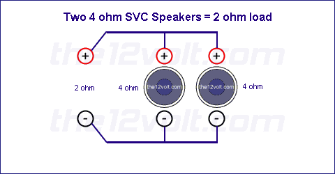

According to crutchfield's wiring diagrams, (2) SVC 4ohm subwoofers can be wired @ a 2ohm load or 8 ohm load.
Since my AMP's manual says 180 x 2 @ 2ohms, does that mean that I can comply with the 2ohm parallel wiring? How should I wire both the subs and the amp?

yes, you can just wire it to 2 ohm and you will be gettin 180 on each channel.

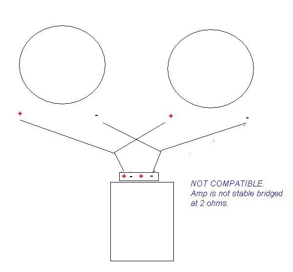

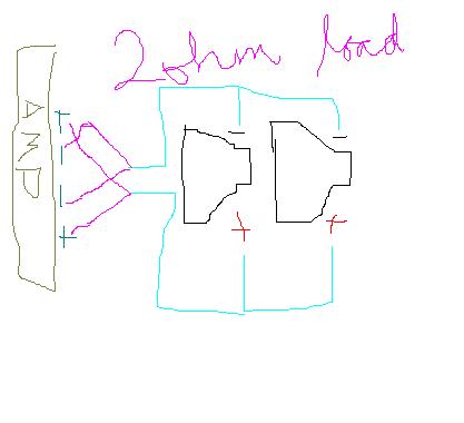

WOULD THIS WORK???

its hard to tell. but r u hookin the sub up to each channel? because thats what he will ne to do if he was to stay wit this amp

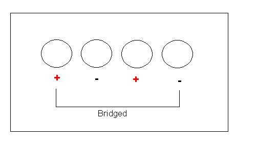

No, Driving, it would not work at all. That's not bridging it. Bridging the amplifier, would be when you hook up only one pos, and one neg (normally shown on your amp near the hookup for speaker wire, which one to plug in, or at least in the manual, if it's bridgeable)
Do NOT hook up your amp like that, you could damage it.

If you look where you plug your speaker wire in on your amplifier, it should look something like this.

who sed i wuz bridging i wuz trying to get 2 ohm loads per channel not bridgeing...

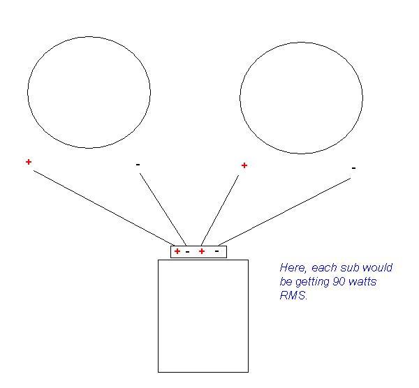

The last one is the one I would recomend, since if you're running your subs in stereo mode, they're each only going to be getting half of the signal (left and right channel going to each sub.) Whereas in the final picture, you're bridging your amp into a mono channel, that combines both left and right into one signal, and is still splitting the power evenly. Also, at 8 ohms, your amplifier will have more control than it would over a 2 ohm load, as well as run cooler. (in most cases).
With your current setup, there is no way to get the full 360 watts RMS from the amplifier safely.

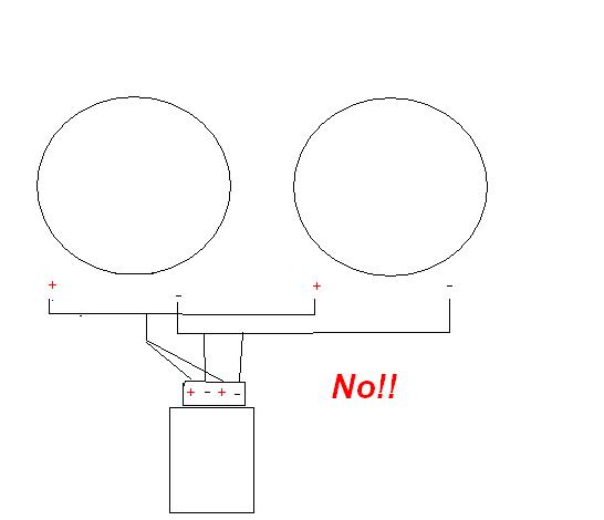

This is what your diagram had pictured...
Do NOT do that! This could damage your amplifier, or subs, or both.
