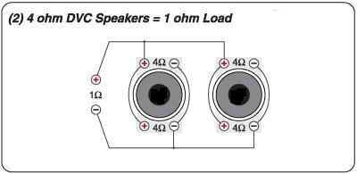

I have two questions, on is I want to connect my two subwoofers to the amp. What is the best way to do this and at how many ohms. And then the second question is, If i connect at different ohms what will be different in the sound of the subwoofers?

Username: Van_man
Boston, MA
Post Number: 394
brigge the amp and wire like this..
250 to each sub.
Username: Thejoester101
Post Number: 19
But this is a 1 ohm load. I need a 4 ohm load.
