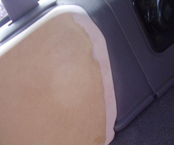

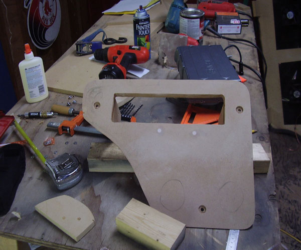

basic cutout of 1/2 inch mdf

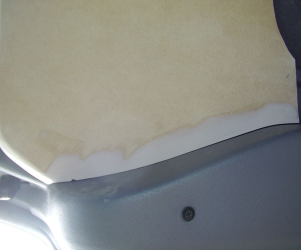

due to poor skill saw skills, i had to bondo (boy do i love bondo) to make all the sides nice and flush and stock
here it is. test fitting the amp
from outside the car. really gotta make a surrounding, eye candy to thieves :-(

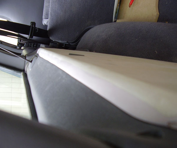

ight time to paint, color doesnt look like it matches due to the sun, but its pretty close.

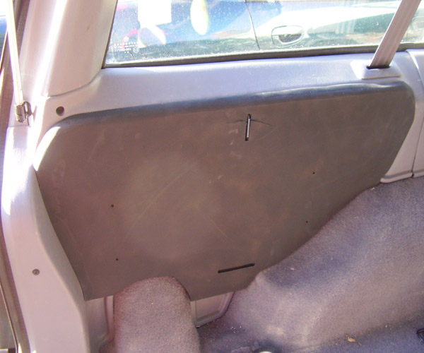

ill have more pics of it up and completed w/ wiring and such. and in a day or so ill have pics of my second project. if anyone knows jeeps, that annoying cutout in the back on the right panel, well thats where my cd changer is going,

my cd changer is going there. james longo gave me his old cherokee amp rack. it goes on the back of the seat, i might build my box so it has the same angle of my backseat and takes up half of the seat. i suck at explaining stuff (pics soon) and then cut james amp rack in half so the 300/4 will be in there, sorta like an amp corner thing.

looks good. never thought to use bondo for the edges like that, i like it.
how did you attach it though??
also, is it cracked where the slot is cut??
and how come you didn't make it go all the way to the floor?? or will that be covered??

look at the pics with nothing there, theirs this hook like thing that was used to atach the spare tire. well i used that to secure the top with 12 gauge solid wire to the board, then two bolts at the bottom to secure it as well. also brandon, it will prolly be covered cus it looks really appealing fromthe outside of the car (thieves) and didnt have enough mdf to make it go to the floor.

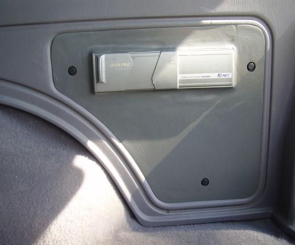

my 300/4 gotta sit on the floor till i make my new box and modify another amp rack
heres where im puttin my cd changer. a little more adjustments to get it perfect and a couple coats of paint. :-)

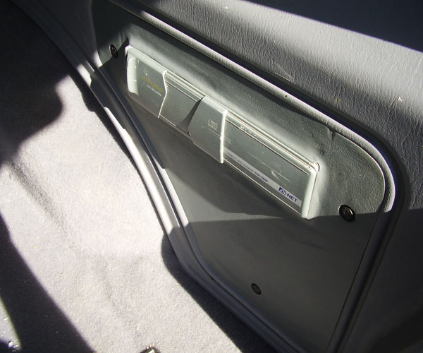

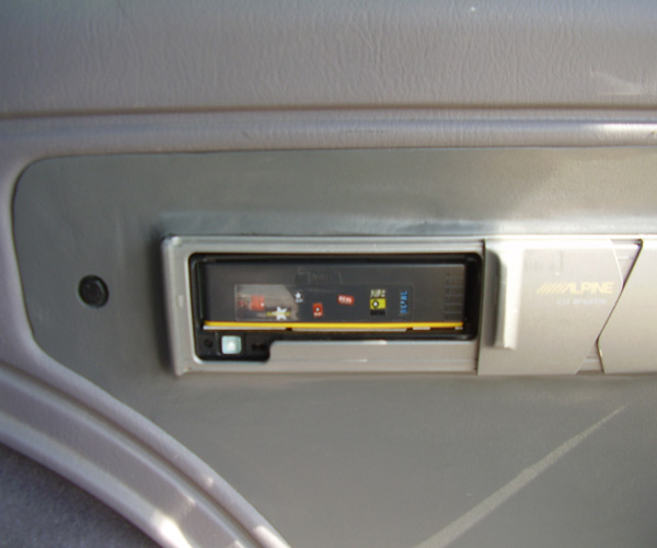

finally done with first two project. very impressed at myself how nicely this fit in with the car. oldschool alpine cd changer. date on back said it was made in 1995. works like a beatuy still. bought it in 2000 for 30 bucks from a neighbor

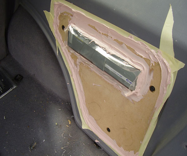

once again, BONDO. its so brittly i decided once it was dried, i used fiberglass resin before paint to make it a little stonger.
test fit
same color paint as my amprack, it has a nice texture to it too.
thats it!
