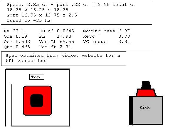

I looking to build a new box for my 12" L7 Im toying with this design. It will be tuned to about ~35hz And 3.5 cf. I just got to figure all the logistics out.Port lengt, Size. (jump in if you want) Anyway, whats the diff of mounting the Sub inverted?

Thanks, Well now on to the math.

Just an overview... I want to make it a cube to match the L7 design Im thinking ~ 18x18x18. I need to find a program or something to try and get it at 3.5cf tuned to ~35 winsled or whtevr wont run for me for some reason, and that other Pedal thing is down or busy. Zapcoe may be hogging it right now. Lol

Sorry for the bump however, Is 35 a good tuning for L7 ? my current box is at 30 but I see some ppl going up to 40. What is a good daily driver setting? Thanks Does any one see errrors with my calcs? Did it by hand, couldnt find a site to just plug and play. Does any one else having trouble getting into Accped.com site.?
