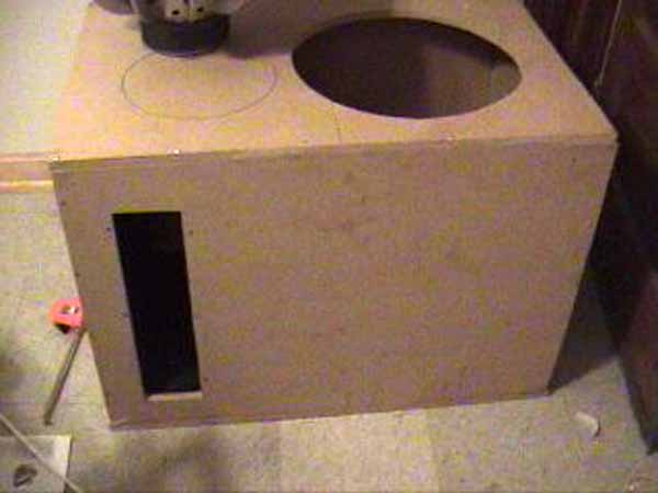

i want to make the top portion of my box plexiglass is this a good idea??? i can get 3/4 thick plexiglass...reccomended????will this affect the sound???

Username: Matt12490
Benicia, California USA
Post Number: 874
Registered: May-05
i think it will be fine. i heard the minimum should be 1/2" so 3/4" should be fine. as far as sound quality i think it wont be affected as long as there are no air leaks. im not sure what you are supposed to glue it with like all wood boxes. that would be another question. make sure you predrill every hole with plexiglass!

Username: Alex_f
Lawrenceburg, Ky Us
Post Number: 827
You would be crazy to use 3/4 inch plexiglass, because it is crazy expensive. 1/8 works fine.
Username: Redliner
Wilmington, Ma
Post Number: 1894
Registered: Jun-05
just remember plexi is really expensive measure 3 cut once
Username: Drivingreckless
Near tampa, Florida United state...
Post Number: 440
Registered: Apr-06
my frins dad sales it so i can get it cheap :-O also u sed glue or drill???? or both????
Username: Matt12490
Post Number: 877
Registered: May-05
first off dont listen to that guy. 1/8" is just stupid. i didnt say to glue it, i was saying i dont know what to use around the edges. i would deffenetly screw it down tho.
Username: Alex_f
Lawrenceburg, Ky Us
Post Number: 829
well, it is easy to crack. If its a smaller peice, you want 3/4inch mounting area all around. if its bigger do 1inch. And use a drill bit first.
Post Number: 441
Registered: Apr-06
oh okay-basically treat it as wood seal it glue it and drill it
Username: Redliner
Wilmington, Ma
Post Number: 1898
Registered: Jun-05
use a small drill then go bigger take your time dont rush it then i would put some clear glue on it and screw it down but thats just me im sure you could get away with just screwing it though but it wouldnt be sealed as weell as it would if you use glue
Username: Matt12490
Post Number: 883
Registered: May-05
i think you deffenetly need some kind of glue
Post Number: 442
Registered: Apr-06
right i probably will seal it with silicone and use sum kind of clear adhesive.but yes i get wut ur sayin take my time and make it look nice....im only making one side plexiglass so i can show off the magnet...also stick sum blue or green neons in the box and make tth sh!t pleasing to the eye at nite....
Username: Rzarector
Coquitlam, Bc Canada
Post Number: 1206
Registered: Dec-04
you could use 3/4 inch plexi and it would be fine.. i would do a double layer of mdf wherever it is going so you can inset the plexi so it is flush with the wood.. use a countersink bit on the plexi and screw it into the mdf.. use clear silicone where the plexi contacts the wood.. maybe even let it set up a little bit before you screw it down.. the silicone will act as a airtight sealUpload
Post Number: 449
Registered: Apr-06
tht is actually a very good idea i wuz thinking of makin the whole side clear but i see u have a better idea thnx mark s

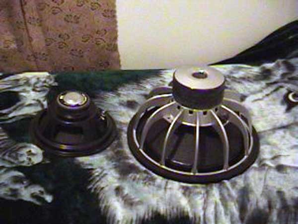

ford explorer wit a dcx precicion power 1500.1 well i gave this amp to my cousin so im lookin ofr another amp that can push more my sx than the precicionpower

Username: Extrmndor3
Chicago, Ill Us
Post Number: 766
hey havoc have u ever saw a magnet of a 18 inch avalanche???
if so u will now for a 18 inch this sx is good enough
Chicago, Ill Us
Post Number: 767
i know the size of the magnet do not meant nothing is how powerfull they are

Username: Tdeaton1021
Near Tampa, Florida USA
Post Number: 2983
Registered: Sep-04
btw. id use the thickest plexi you can afford. or lexan. check ebay. sometimes they have like 1 inch by 12x24 for like 20 bucks because its got a chipped corner which you'd cut off anyways.
