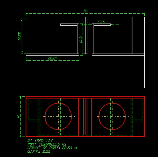

Silver Member Username: DrivingrecklessNear tampa, Florida United state... Post Number: 406 Registered: Apr-06 | B HOW DOES THIS LOOK... |
Silver Member Username: DrivingrecklessNear tampa, Florida United state... Post Number: 410 Registered: Apr-06 | bump...bump...bump...bump |
Gold Member Username: Tdeaton1021Near Tampa, Florida USA Post Number: 2960 Registered: Sep-04 | 2.25 is small. id go larger. |
Gold Member Username: Tdeaton1021Near Tampa, Florida USA Post Number: 2961 Registered: Sep-04 | wasnt your old box like 7.5? and your new one like 8? |
Silver Member Username: DrivingrecklessNear tampa, Florida United state... Post Number: 415 Registered: Apr-06 | IF UR TALKIN TO ME....IDK IF U WERE BUT.....NO MY OLD BOX WUS 2.25 TUNED TO 32 Hz NO THE ONE IM GUNNA MAKE IS 2.25 TUNED TO 35.5 hZ NOT A BIG DIFF BUT WUT WOULD U SUGGEST FOR TREO TSX 12" |
Gold Member Username: Tdeaton1021Near Tampa, Florida USA Post Number: 2963 Registered: Sep-04 | 2.25 to 32 is prlly what id do for a 12. 35 is fine too though. for the 15 id prolly do 3.5-4 to prolly 30-32hz. i was tlaking to B about his last box for his 2 15 tsxs. what do you like better the 32 or 35? can you tell a difference? also, is there a difference in port area? if so how much and which one has more? |
Silver Member Username: DrivingrecklessNear tampa, Florida United state... Post Number: 418 Registered: Apr-06 | WELL...IVE NEVER HEARD 35Hz SO I WANNA TRY SUMTHING NEW..AND ALSO THE 32Hz GETS LOW BU MY SUB TENDS TO BOTTOM OUT AT LOW FREQUENCY TONES.....YEA THIER IS A DIFFERENCE IM NOT SURE HOW MUCH BUT I NO THE 35Hz ONE HAS LESS PORT AREA THEN THE 32 hZ ONE... |
Gold Member Username: Tdeaton1021Near Tampa, Florida USA Post Number: 2964 Registered: Sep-04 | if your going to raise the tune.... raise port area too. and sorry, i thought you said you switched to 35hz, not your going to make it. i wouldn't reduce port area though. also, about the bottoming out... how much power are you giving it? is your SSF set right? and are you using any bass boost? because a sub will bottom out much easier with boost. but that sub should eb able to take quite a bit of power before bottoming out, unless playing say a 20hz tone without SSF. also if your Hu is clipping, there will be a clipped signal right from the start, which will cause it to bottom out easier too. |

Silver Member Username: DrivingrecklessNear tampa, Florida United state... Post Number: 419 Registered: Apr-06 | my amp doesnt have a subsonic filter i wish it did its a jbl gto1201.1 benched at 1049 rms at 2.5 ohms......so yea im over powering it by almost 3 times....and my bass boost is all the way up and im sure i should lower it but ignorance sets in and i want it loud maybe i should turn it a bit lower...as for the hu clipping i dout it cuz i dont hear any clipped signals.... |
Gold Member Username: Tdeaton1021Near Tampa, Florida USA Post Number: 2968 Registered: Sep-04 | if you leave your BB like that i promise you'll damage the sub. and you should look into something that will reduce power at about 30hz and below. get some sort of crossover. actually, if you turn your bass boost down, you can probably gett a little more out of gain, but i cant tell not being there... but if your amp is putting out 1000w with no BB. it WILL clip when BB is applied... if BB added axtra clean power it wouldnt be a 1000w amp now would it? get a oscilloscope or a dmm atleast... that or just listen real carefully.... you'll soon recognize it will play better without BB with the gains set correctly... |

Gold Member Username: B101Queen City, NC USA Post Number: 2840 Registered: Sep-05 | drivingwreckless that box design will getoff regardless, trust me.. |
