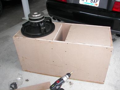

Well it just started raining, so I'm takin a quick break. Hopefully I'll get done today, but heres what ive got done so far. Not all screwed together yet.
Liquid Nails!!! OH YEA!!
No top or ports.
Port and dividers set in.

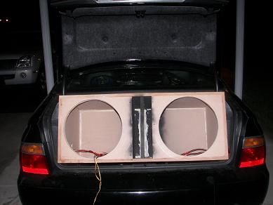

Test fit in trunk. Theres is supposed to be plastic trim in front of the box, but i had to take it off the trunk to squeeze the box in.

In the trunk with top on.

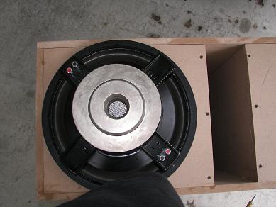

The SSIs.

WUT UR VOLUME AND WUT IS IT TUNED TO...NICE JOB BY THE WAY

2.79cu.ft. exactly after displacement(per sub), its tuned to ~35hz.

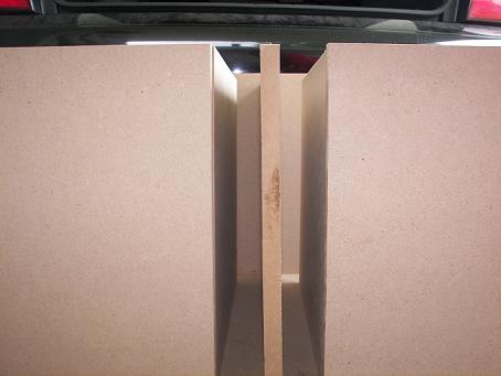

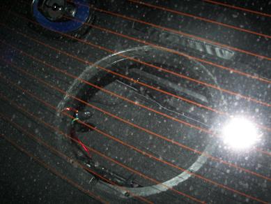

Heres some pics of my back deck w/ the port....It used to have a 12" sub in it.
Looking Up from the trunk.
Looking thru the back glass.
Looking thru from back seat.

nice looking box man - but i must ask , it appears 2 me from ur pix that ur box is almost touching the tailgate ,
if it is then how do u expect 2 get any resonating bass ? , cause it seems 2 me like it will rattle the hell outta ur trunk lid/tailgate with it being so near ........

It just looks like that, its about 8-9inches from the back of the trunk, but its only about 5inches from the top of the trunk.

er ok - its hard 2 judge distance in a pic like that
u need 2 seriously deaden ur trunk if u already havent done it as yet - also try facing box 4ward too when ur done 2 see which sounds better 2 u ....

If you look in the 3rd pic of my port then you can see the Dynamat Xtreme on the back of my trunk, I've already done all that before i put in my last system. I doubt i get that box back out easily, i had to kick it into the trunk, it was a tight fit.

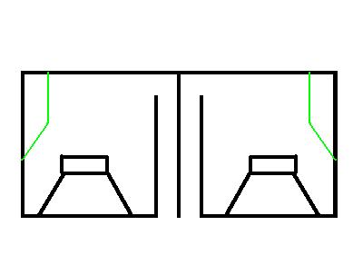

Dammit. My box is about 2 1/2 inches too wide in the back to slide it back as far as I want it to go. Which means I'm going to have to do this to get it to fit right.
I'm going to have to cut off where the green lines are.

that will change tuning, just remember that.

I know...but it'll only take it down to about 2.6per chamber and i think thatll put the tuning around 37hz instead of 35. That shouldnt make too much of a diff. i dont think. I could always add a couple inches to the port to get it bcak to 35hz.

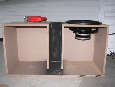

DAMN IT!!!! Heres whats left of my box! Time for another, unless this one can be repaired.Upload

dude that sucks id make another box but this time make it a lil small to account for your trunk space and air flow

damn, look like something ate away the top...

The reason it looks like somethin ate away is b/c the top cracked, then I had to try and get it off, and I had to pry it off b/c i used plenty of LN to glue it. and i just realized I didnt post a pic of the top after I took it off. Damn it. LoL. I would forget the best one. Anyways I tried to fix it, but it isn't near as loud now b/c nothin went back together right, and i had to caulk a few gaps. O well...I'm making another soon, this time with some aeroports.

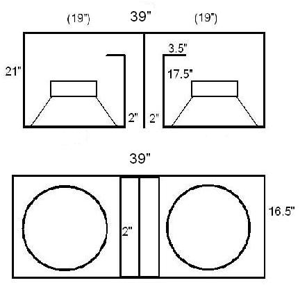

Username: Northomaha
Post Number: 66
hey can you send me a drawing with all of the dimensions on your first box becuase I have two TSXs and i need to build a box for them.
my email is reminc70@ops.org
thanks alot
Username: J_baby15
Kentucky
Post Number: 328
couldnt email it, but heres a drawing. The box is tuned to 33hz. the port is 15x2 adn 21" deep.
Post Number: 70
do you know what i would have to do to get that tuned to 36 hz, i imagine it would involve the length of the ports but i dont no if it would be less or more and how much
Username: J_baby15
Kentucky
Post Number: 330
Make the port about 16.5" long instead of 21" and itll be around 36hz.
