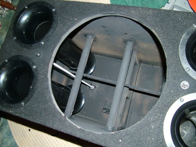

Finished my aerobox, what do you think?
Username: Terry6405
Sullivan, IN US
Post Number: 755
Registered: Sep-05
im pretty proud of itUpload

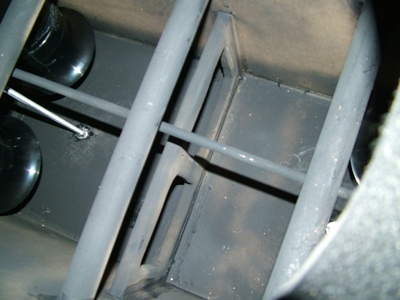

are those black braces dowel rods?
if so how good do they work in your opinion

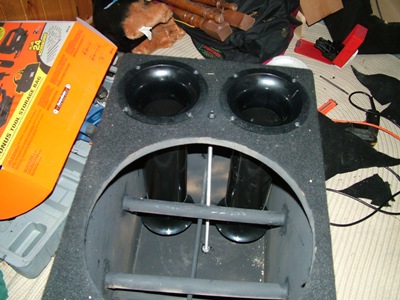

hmmm 4 aeroports - im no expert @ aeroports but somehow im thinking 2 would be sufficient ,does look very killer though ...

well i think aeroports are like 10-13(sumwhere in there) sq inches in area so i think 4 would be about right rov.
i was thinking bout using 3 6 inch or 4 4 inch ports with my havoc

the dowels really do sturdy up the tp of it, and yea they are the three thick ones that go right behind the sub
i dont know why but at the last minute i decided to spray the inside black, steath i guess, only cost a buck so.....

looks awesome man, you gotta tell us all how it sounds, my last box that was aero had only two but they were a bit longer so i bet four is just about perfect.

yes i am dying to hear it too, btw they are just the precision ports from partsexpress.com, and i didnt cut them so they are 17" of port - 18" total after flair--each

very solid looking box terry nice job, 1 recomendation.. you could have done a double front baffle and hide those nuts while providing more security for the sub.. also maybe the pictures just decieving but how far are the ends of the ports from the back wall of the box? they should be at least the width of the port

I would bet with the full length ports it is tuned between 40-43hz but hard to tell without the exact enclosure volume, and the displacement of the sub, ports, bracing. Looks good though, keep us posted..Polo. :-)

i thought about a double baffle, but then i would have lost some cu ft, and the box i built is the absolute max that can fit in my trunk, and i mean that too, i will have to kick it in
it not that high, i more that over compenated for the displacement, its at most 38hz, but i think its about 37. but thats just based on the calulator i had on the bca1 site

Very nice. However, I would have built it a little different.
The single reason for dowel rods and threaded stock was for rigidity right?, well as this does do the trick it also hurts in other ways.
Internal turbulance is important, all that money on "Aeroports" is almost wasted. The air's velocity is copromised with all the rods inside your box.
If weight and a little extra size wasn't a factor, then building the box with double or even triple walls would have been ideal.
Here's another little trick for any of you that decide to get competitive...Take some 2" PVC pipe, split it down the middle using a jig saw or di grinder. Now, cut it to length and glue it to each inside corner, (along the box where the top and sides meet, along the bottom where the sides meet, ect).
Now, use some thin sheets of fiberglass and resin in these new "rounded inside edges".
After the box's corners and inside edges have been smoothed out go over all the inside panels and cover them in with resin. After it is set up you should sand the insdie of the enclosure until it is smooth, the next step is to go over it with a shiny coat of paint.

so should i get rid of the dowels? what if i just got rid of the let and right ones and kept the middle for the extra support? i really think i need the allthread because otherwise the box would be too flimsy
the most i would take out is the dowels, and i might do a little sanding because the glue is pretty rough, i didnt know this little stiff made that big of a difference, i might try the corners thing on my next box
