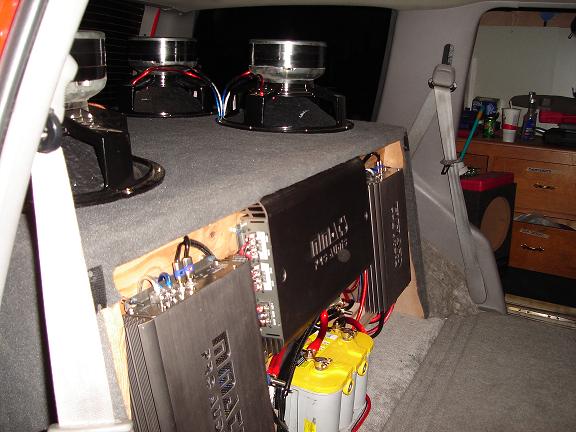

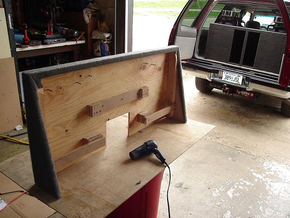

These are Digital Design (4)9515's, and the 2 smaller amps are Mmats 3000.05's. There is also 3 more Optima yellow tops under the hood.
I finished the install with
2 7" headrest tv's,
2 7" sunvisor tv's,
a 4" rear view mirror tv,
a 7" flip out dash unit,
a 20" flip in the rear, (it replaced 2 15" flips, they made the headrest pointless cause they covered up them up when down, thats why I took them out and put one 20" in the center), and toppped off with 2 cameras.
The highs consist of 2 pair of MTX TXC6.1 components powered by the Mmats SQ 4160.
The rear seats fold up in the full factory postion, the rear screens allow the amps to breath a bit, i placed a small LED in each amp, at night all you can see through the grill cloth is the MMATS logo in the center of each.
(the amps aren't visible at all during the day, i think it was the camera's flash that shined through the cloth in this pic showing whats hidden inside)
I know this install install isnt spectacular, It's purpose was to be loud, thats it. I decided to put a clean finished look late in the install.
Tell me if ya guys like it...

So - if im seeing correct ur using 1 mmats amp on 2 subs ? specs wise im thinking each sub can easily handle 1 mmats 3000 each ? .......

Wow!!, thanks guys. Feels good to hear positive comments.
The install took me 2 days for the audio portion, which I finished over the weekend, the video stuff took 3 days. So 5 days total.
Yes, those subs could handle a MMats each, but for daily it would be almost impossible to feed 4 3000.05s enough current without building some crazy "Alma" bracket that housed half a dozen alternators lol.
The guy isnt interested in competing, he just asked me to put a system in his truck that would never, well i'll put it in his words,
"I want to keep my backs seats first off, now, hook me up with somethin that no matter what nobody can pull up next to me and shut me down, no, I don't care how much it costs either".
So, thats what I decided to put in. I figured that was about as much a 250 amp alternator and 4 optimas could supply.
I'm not sure how loud it is, I have him coming in later this week to tweak the system, I'll put it on the TermLab and let ya guys know how it fairs.

how large is that port(looks like atleast 20x6 each) and whats it tuned to? and when you say you dont know how loud it is... you havent even heard it? or you dont know the number?

WOW great install! Waiting to get all of my stuff in, and if mine is half of that I will be satisfied. My question is, doesn't the amp rack screw with the ports? I would think it wouldn't sound as good with the ports blocked like that. Great install though!

andrew, the amps are on the front side of the box and the port on the rear. you cannot cover ports up.

I was just jokin guys, :P, it does a solid 155 on the TL.

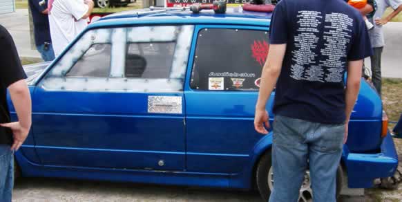

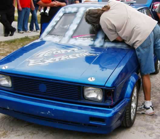

this car did like mid 160s in the port of an eclipse ti pro 18"... they made a bet on what it would hit and the winner got a case of energy drinks
