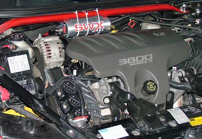

is it a good idea to put a cap between the alt and batterie the cap will be waterproff and all that im askin this cuz i have a stock alt and im runnin a precicion power dcx1500 at 1 ohm and 4 channel phoenix gold amp and alpine deck plus lightin, it will be better????i will have more stable output???and is it worth it???
oh i toolk these pics from a dude called Peter Dyrke in the speaker foroum

if you are determined to run a cap...have it as close to the AMP as possible. (1 ft would be good)
it can help to filter the AC-ripple from the alt.
BTW...i have never seen someone put a cap under the hood...lol.

probably not a good idea to have it under the hot hood either

don't get a cap unless you have a ho alt. and most people say 6inches is optimum distance from the amps, no more than a foot. you want it as close to the amps as possible to deliver the extra power they store.

1) a cap has nothing to do with the starting of the engine, hot or cold.
2) a cap under the hood is a bad idea because the main purpose of the cap. is to smooth the ac ripple and deliver bursts of power at times of high demend when needed by the amps. thats why you want it as close to the amps as possible, for the power going from the cap. to the amp has the shortest distance to travel. it in no way helps relieve stress from the alt., just adds to it if the alt. isn't large enough.

thats just a fire hazzard waiting to happen...

the dude from the photos said that the output got cleaner and dimmin free plus his noise problems got solved

LIlrob, listen to what they are telling you! Fck that guy that took those pictures, looks to be of a Grand prix GT. That cap should never have been wire-tied to the after market steel tower support rod it is a fire waiting to happen. By the way, I think he is running a stock alt also Here is a picture of my engine which is close to his but MORE balls, note the difference of his alt to mine (300A) and also note, NO CAP! Polo. :-O

Oh and also if I am not mistake, the increased heat will bring up the ESR value of the cap, coupled with the extra length of the power wire will probably make it useless not to mention cut its life really short...JMHO..Polo :-)

i think your nuts putting the cap on top of your engine there
