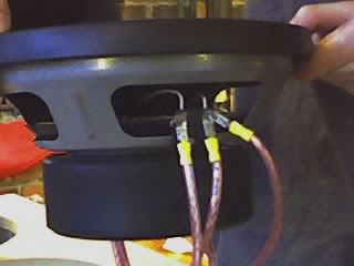

I have one New 06' square l7 kicker that is 4ohms. And then I have a new memphis mono amp that is rated at 1100rms. What is the best way of hooking this up can someone help please, I need to bang.....

What is the model numbers of your sub and amp? If the sub is DVC 4 Ohm then wiring in parallel will present a 2 ohm load. Depending on your amp model, you may or may not get all 1100 at 2 ohms.
To wire in parallel:
^ ^ Connect the + on one voice coil to the + on the other vc. Then connect the - of one to the - of the other.
^ ^ Then connect the + of one VC to the box, and the - of the other VC to the box.
