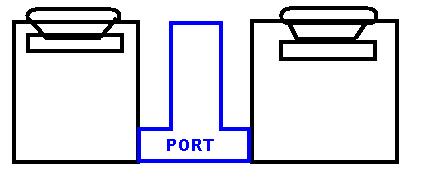

New box design. tell me if this would be a good idea
Los Angeles, CA USA
Post Number: 3732
i know the drawing kinda sux but i just want to get an idea. the center piece is the port. i figured having the port stick out the box would give me more cuft inside the box.
Username: Extrmndor3
Chicago, Ill Us
Post Number: 508
i think u need to put another mdf on each chamber cuz that port is too small and i think u want a slot ported right
Los Angeles, CA USA
Post Number: 3733
okay i am sure when i go to tune the box the size of the port will be different. the drawing is not to scale. its a rough sketch of the idea i have. from each box there will be an opening at the bottom and meet in the center.

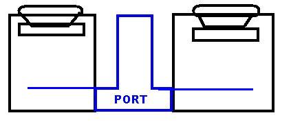

I dont understand do you mean something like this.
Los Angeles, CA USA
Post Number: 3734
okay let me explain a little better. it will be 2 separate boxes. the blue thing is the external port. the box will fire up.

Well if they are both on the same mono amp I would think so.
But I would add a partition but thats just me I only have 3 boxs under my belt so far.

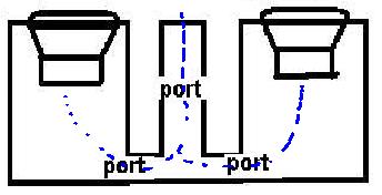

I think this is what he means...
Username: Insearchofbass
Post Number: 4777
Colby's example illustrates Chad's idea best I think but you could also do a pvc wrap around (external) like Ive posted on this forum before from someone elses website
