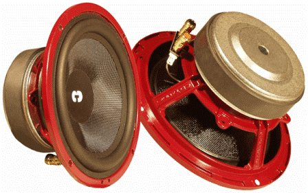

O and just to let you know.............. Upload
new CDT driver, 10hz-4khz,,,150rms...let the midbass begin.
07 7in driver is quite nice and the drt-26 tweet is awesome.
