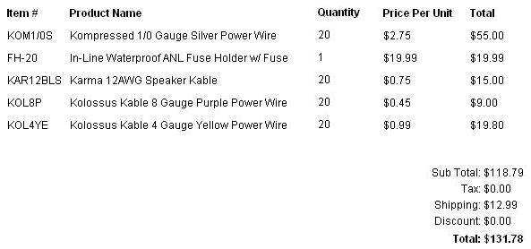

As you can see - shipping through them isnt that much.. :-) And honestly, good luck finding 0 gauge at a local retail shop for $3 a foot.. Most places (again, in my area) Charge at least $4-$5 per foot.. And it has nearly 1,000 less strands than the KnuKonceptz equivalent.

damn those prices are sweet.. :-) I know where 2 buy in bulk now!! cant belive shippin... my dealer does for me 3$ a foot.

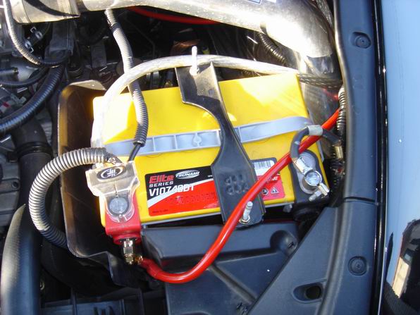

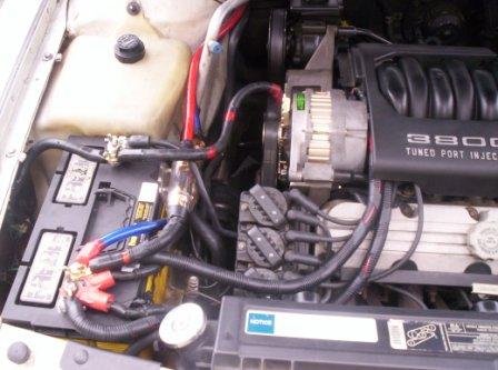

Here is a paint image I made of how I upgraded my big 3.. (very easily..) I'll list what the gray numbers are below the pic..
1. This is my upgraded alternator to battery wire. I run my 0 gauge wire to a distribution block a short distance from my alternator, then have 0 gauge wire going to my front battery, and a 0 gauge wire going from it back into my car.
** The reason I do this, is it's a good way to avoid running like 3 feet of wire to your front battery, then running a wire from your battery back.. It pretty much just saves you from having to double back on your wire.. And the less wire length, the better.. (can save like 5 feet by doing this.. 2.5ish from alt to battery, then the 2.5ish that you'd use re-covering the distance on your way back to your vehicle cabin). Also, makes it MUCH neater, as far as the number of connections go to your battery, especially for you guys that dont have side & top mounts, just one or the other.**
2. This wire is my upgraded Battery to Chassis wire. I also run a seperate 0 gauge wire back to a distribution block near my amps/2nd/3rd battery as a dedicated ground that originates at the the point where my connection to the chassis is made.
**Doing this - it's not only upgrading one of my big 3, but it's also like I'm running an un-interupted line of 0 gauge back from my front battery.**
3. This is another 0 gauge wire with a ring terminal I put between one of my alternators bolts, and the mount. This acts as my engine to chassis.
**The reason I chose this spot, is because the main reason you need to upgrade your cars engine to chassis, is for your alternator.. So actually having a ground wire attached TO your alternator, is more efficient than upgrading the wire where the stock counterpart is. (Basically, lets my alternator ground directly to the battery, since this wire is also attached to the ring terminals where my battery to chassis ground is made). Pretty much, lets your alternator ground - without going through your engine, that's grounded somewhere else to the chassis. Think of it, as like keeping your ground wire as short as possible, and your engine being like 4 feet of un-needed wire.**
All the wiring shown in this diagram, is added to all of the stock wiring. (The dashed black line, is my dedicated ground..it's dashed since it's not a mandatory part of upgrading your big 3.) I left it all in place, as removing it serves no good purpose..but actually does just the opposite.
I hope this helps, and makes sense.

yeah thanks seth that helps alot. see if i got the picture right then.

I'm not 100% sure about your alternator, but to me, it looks like the one you have as your 'ground', is really your power, and your 'power', is your plug in that should be identical to your current alternator.. (think of it as like a remote turn on for your alternator). The ground would be where it's bolted to your engine.

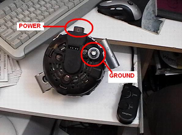

seth, where do the cables that i highlighted go to? i am gonna have the alt installed but i will be upgrading the big 3.

CHAD NO!!!! The bolt on the back of the alt is POWER and lots of it, lol. Technically it is case ground, meaning by bolting to your engine which is already grounded thus grounding the alt also. The wires for the plug in is to supply power to the regulator and for your battery light. Unhook the belt before you start not to mention disconnect the battery. To get your belt off locate the idler pulley and using a boxed end wrench (mine was 15mm) on the bolt in the center of the pulley and push in on it either clockwise or counter clockwise dependant on your engine. You will notice the pulley moving (takes a good amount of pressure) under a lot of spring pressure. try and hold it down with your left arm while using your right hand to slip it over the pulley end. Once it is off JUST the pulley for the alt, gently place it so it won't fall and you won't have to do the belt from scratch, meaning don't let it fall for you will be looking for the belt routing diagram real quick, lol. I would go to Auto Zone or such and invest in a Hase book appropriate for your vehicle, worth the $14. Polo.. :-)

WRONG = DO NOT DO THAT...
DO NOT DO THAT^^^^^^^^^^^^^^^^^^^^^^
Like Polo said...
The Bolt to the back is the POSTIVE form ALTERNATOR! Run 0ga from that bolt to POSITIVE of the battery!!
The part u labeled as power, is actually where u plug your gauges harness into!! This is what shows your voltage reading on the dashboard..\
Anything metal resting on the engine frame will be grounded!! SO when the alternator screws into place, it will be grounded!! However U can upgrade the engine to ground connection, by adding a 0ga cable from the NEG of the battery, to the alternator MOUNTING bolt!!! that will screw it back to the frame, with a ring terminal!!

okay i got what you are saying. i am going to leave all the factory cables there and just run 0gauge from the bolt to the battery positive straight. also check out this picture. that is the idler pulley right?

Chad, in the pic, those are the wires that go through my firewall back to a dist block and my 2nd/3rd batteries, etc.
