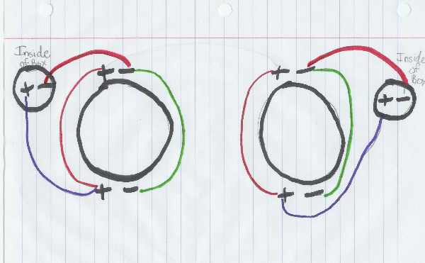

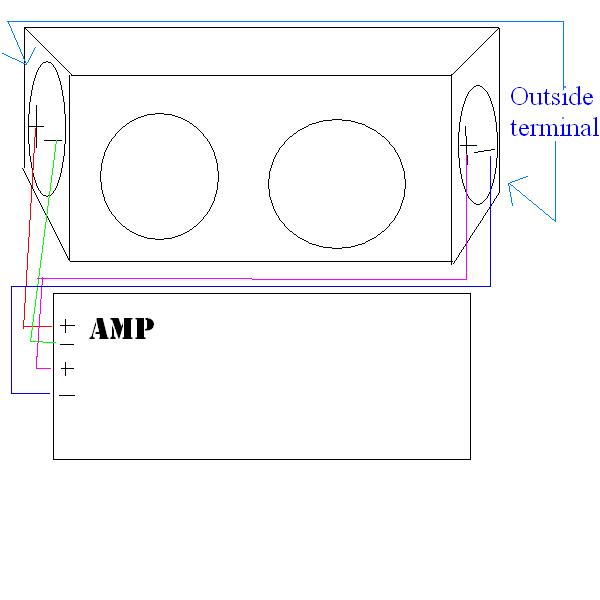

Okay I just hooked up my subs and amp. I am getting no sound. The amp is getting power though. Setup: 2 SPL JWS ( same as JL W6 V1s) 12" DVC 6 Ohm 1 JL Audio 500/1 amp. Below are diagrams of the setup. First one is the outside of the box. The second is of the inside of the box. Any questions, just ask. Thanks.

you running a 2 channel setup??? I would wire the subs in parallel and run it at mono

OK. Yes, all of the settings are turned completly all the way down. I ran a remote wire, the amp is getting power. And I thought that I ran them parallel/parallel. The amp is mono. I am running 2 subs though.

Does it matter that the subs are wired to the inside of the box then from the terminals to the amp?

^ no that doesnt matter

OK. Figured it out. It's in the wiring. I hooked them up normally and they work fine. Somehow I didn't do the parallel/paralell the right way. I will try to post some pics of the wiring.
