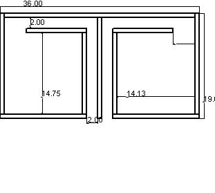

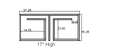

New member Username: Da_manPost Number: 4 Registered: Apr-06 | does this look right? http://i1.tinypic.com/v7tb8w.jpg |
Silver Member Username: GoatinU.S.A Post Number: 733 Registered: Jan-06 | I just built one kinda like that for my R's and it pounds. Altough I am unshure of what it is tuned to. It only took me ~3-4 hours to make, And you can get all of the pieces out of 1 4'1" by 8'1" sheet of MDF if you have a table saw. |

Silver Member Username: GoatinU.S.A Post Number: 734 Registered: Jan-06 | http://www.accelerator-pedal.com/l-ported-box.htm I dont know exactly how to tune but this site will build you a tuned box design instantly. |
Bronze Member Username: TippindownPost Number: 44 Registered: Mar-06 | i tried doing that site but i dont know what half the stuff is lol so could someone finmd it for me? the height is 16 and width is 36 (max for trunk) and w/e tuning freq is best for 2 12 inch type r's |

Silver Member Username: GoatinU.S.A Post Number: 744 Registered: Jan-06 | 16" H Baisicly the same box I am runing just tuned a bit lower. |

Bronze Member Username: TippindownPost Number: 45 Registered: Mar-06 | hey rave thanks man do u know exact what it tuned? and how deep is it ? its 19 something but it got cut off |
Bronze Member Username: TippindownPost Number: 46 Registered: Mar-06 | and there also aint a measurment on the second wall of the port, any idea what that is? |
Bronze Member Username: TippindownPost Number: 50 Registered: Mar-06 | well im guessing that the side is just 19 by adding it up but not enough info to tell the the length of the port that goes side to side, u know what it is cuz i wanna get some mdf tomorrow and get the box done |
Bronze Member Username: TippindownPost Number: 52 Registered: Mar-06 | rave?? u know what that measurement is? |
Silver Member Username: GoatinU.S.A Post Number: 762 Registered: Jan-06 | Its 19" on the side and the one I forgot was 4". I am unshure of what it would be tuned to I just know its lower than my box because of port area but it should not be too different you wil have 31" if port that should tune it around 30hz I think . |
Bronze Member Username: TippindownPost Number: 55 Registered: Mar-06 | sweet thanks man i really appreciate it |
