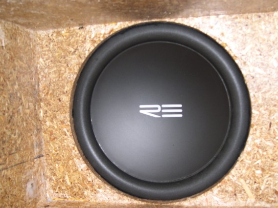

My TCAB box isn't MDF or particle, looks like chipped stuff @ 3/4" and it hits, also is MUCH lighter than other boxes. The whole inside has been coated in resin and the corner closest to the ports has been filled, glassed and rounded to aid in airflow but that is it. Polo..

luckily u coated it with resin cause if water hits that wood it swells up & u gotta toss its @ss out
that wood is def not my choice even if i got it 4 free i would think twice about using it 2 build sub boxes ........
I bought this box from a reputable box builder, local for me. This box with a 15" R and 1500wrms was running better than a 151 db on the TL. The wood is made by Georgia Pacific and have to say he got it from Home Depot, 3 blks from his house. When the bass hits the sides resonate very little even without bracing. I would like to try building the same box over with MDF, just curious. Polo.. :-)

well maybe the quality of that chip wood sheet is much better nowadays cause i used similar looking wood yrs ago & it was terrible back then .......

no its still not that good and the only thing keeping it half way decent is the resin soaking in there and sealing it up. It is light weight though but I would use actual fiberglass first before I used that kind of wood.
