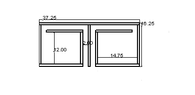

I want to build a ported box for my R's.
Will this work or would the tuneing be all off?
I would like to tune it to ~30-35Hz.
My max width is 37.25" and max height is 17".

Rave'n if you want to tune it to the frequency you want, your ports need to be longer. to tune your box to 32hz your ports need to be 30.68 inches. make sure you measure the center line of the port to get the length.

I should have 32.5 inhes per port. So do I need to make my port opening smaller?
And What exactly do you mean that my ports need to be longer?
Do I need to add more baffles for a longer port length?

i am just saying from looking at that picture the ports don't look like they will be 30 + inches.

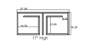

So it will work? I just really dont want to hurt my subs.
and because its cold today I can finaly get a chance to build my ported box.
Here is a more detailed Version. Any ideas on what I should change?

also you won't hurt your subs. infact with the tuning you have in mind, it might sound alot better and louder. i personally liked the type Rs in sealed though. its just some subs sound better sealed and some sound better ported.
btw my type Rs were tuned to 40hz when i had them ported so if you tune it low like you wanted then it might sound much better.

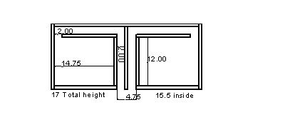

This was my final design^^.
I had to take out my backseat just to put this thing in how I wanted.
It gets a lot deeper now and is very punchy, But there are some bass tones that I dont think sound right that sounded great before .
