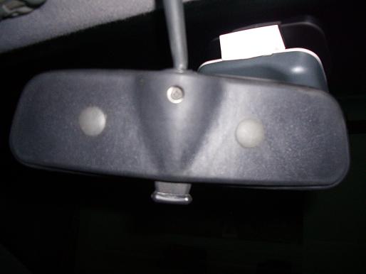

I have a pretty decent solution that worked for me:
Take the mirror off and drill 2 x 5mm (~1/5") holes at equal distances apart (to look even and neat) on the back of the mirror. Get some sikaflex and fill the cavity up as much as you can. Place 2 flat plugs, same color as the mirror, into the holes. Let it dry and then screw it back on.
Hope this helps

Matt, this is what im talking about...drill 2 holes and fill the cavity and put 2 plugs in place..

what is the slikaflex? and where do you get it? and the plugs also?

Just go to any auto upholstery place to find some some plugs, they are merely there to cover the holes. Sikaflex is just like silicon. It is a flexible glue/sealant. Available from any hardware store.
