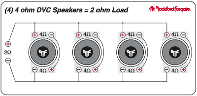

Silver Member Username: GoatinU.S.A Post Number: 686 Registered: Jan-06 | I am not shure what ohm's your subs are 2 or 4 but make shure it is all wired like this if it is 1 channel amp |

Silver Member Username: GoatinU.S.A Post Number: 691 Registered: Jan-06 | Bridge your amp and wrie them like this. ![]() |
