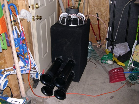

Make them yourself.. saves money and its pretty easy.. Upload

Username: Jbump
Nebraska City, Nebraska USA
Post Number: 213
Registered: Dec-05
I can change the lengths with mine.. you can see the joint in my pic.. they're tuned at 35hz, but for SPL, i could tune them higher if i want too..

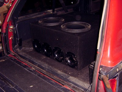

Username: Safe_cracker
Chicago, IL US
Post Number: 666
Well My box is 4.47cf, with four 4" aeros and each has a length of 18.5" including both flare ends. Do not mix lengths you will get very poor results. My box is tuned to around 40hz but in vehicle it comes out to around 36-38hz, dependant on conditions. If you are short on space you will not get this box or your either with external aeros, takes up a lot of room. I really don' think anyone in IN can handle this box anyways, lol. Polo.. :-OUpload

Username: Jbump
Post Number: 215
Registered: Dec-05
i used a torch to heat them up and flare them on a bowl.. some people use a heat gun, less worries about burning the PVC.. took my a couple test runs to figure out how to heat them up without burning them, but it works... then just flange them on a flat surface.. i used my work bench.. takes a wile to let them cool so they hold their shape.. poor cold water down the PVC to cool it so it'll stiffen, then i used a router bit to counter sink the screws...
Chicago, IL US
Post Number: 674
Do you really know how long the ports would have to be to run those large dia ports? Four 4" port are quite extreme area wise, a program will tell you one or two for it to tune right. When I say in car tuning I mean when played in the vehicle after the sound has been beatin up by your cars interior it will tune a little lower than the port tuning itself. This box can play from 20hz to 80hz, running extremely strong closer to the middle. Round ports are able to play more frequencies due to a less sharp cutoff unlike slot-ported enclosures. The smaller the box you use the higher the tuning and longer ports you will have to have. Polo.. :-)
Chicago, IL US
Post Number: 678
Funny you can get different answers from different sites. You screw them on the inside of the box and put them together outside, use electrical tape to hold them together. You must seal the inside flare with a sealant to maximize efficiency. With Aeros I would not try to use an elbow because you would be defeating the purpose of an aero which is to minimize port noise by adding a restriction in turn will be noisy. You may be better off with a different box like this one but with one sub?Upload

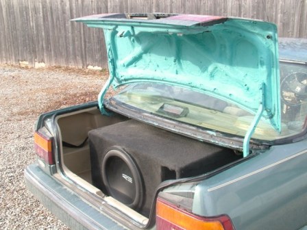

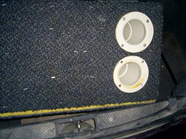

Hard to tell maybe post pics of the trunk interior space and maybe a picture of what it looks like behind the back seat. Polo..
Username: Terry6405
Sullivan, IN US
Post Number: 615
Registered: Sep-05
these are pics i had
that box is 31" wide x 16.5" tall x 23" deep
you can sorta see the box behind my old amp
im almost positve i can fit the box i said b4, but the total net volume will only be like 4.6 cu ft instaed of 5
does that sound like it will work to you thou?
i really think it will
another plus about facing the ports in is that the air will keep the amps cooler because it will be blowing directly on them with the back seat up, so it make sense to me
