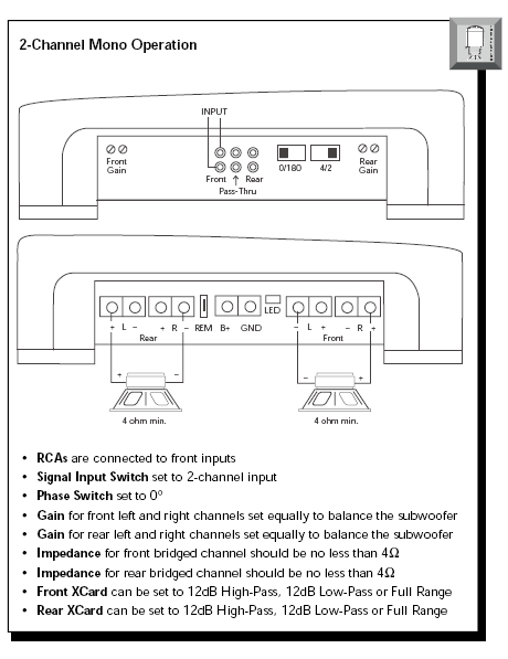

I just hooked up two Orion HP 124D's to a Punch 400.4. The 12 are wired at 8 ohms each then bridged into the Punch. My box has no divider and the speakers are moving out of sequence. Also, the 12 on the right sounds distorded. Any ideas?

As for craig, double check to see that one of your subs that the wires arent crossed, + wire going to the negative terminal or such. Its a common error and happens to the best of us.

Thanks Jeff,
Exactly what I thought too. I checked the wires right after I left the first post and they were wired correctly. I then found out that one of my channels is blown. The amp is very old and needs to be retired. This gives me a good excuse to buy a new one tomorrow. HEHE!! The little woman is not going to be happy though.
