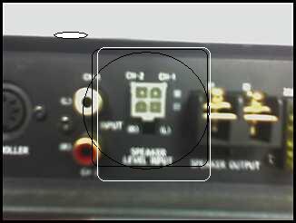

Bronze Member Username: PprashPost Number: 14 Registered: Mar-06 | AS SW9152 u already know my thread was gone bro but never got real help except what u told me.. here it is for others.. I have corolla 2003 with stock deck. I wanna hook up my system with amp. Deck has no rca'a option 1= get a new deck so i get rca option 2= Just get Line output converter LOC I am outta some money so i was thinking LOC would be cheaper bet.. Ps SW9152 said i have speaker level inputs and i can run signal frmo rear speakers.. Well this is the situation can someone Please tell me the best cheapest situation. i also wouldnt really wanna get a deck right now.. stick with stock:S Thank you |

Bronze Member Username: PprashPost Number: 15 Registered: Mar-06 | thnx guys. i dont know how to open my dck and actually install LOC so my amp does has speaker level inputs but i dont have a wire to pplug in the plug is like 4 squares chich says ch-1 ch02 (l) and® which is left and right.. where can i get the adapter and how can i run the pick up signal from that... ALSOis quality going to be really bad? like how muuch difference ther eis going to be in terms of loudness and quality frmo after market HU? its an 03 car the deck sounds decent tho |

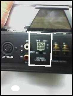

Silver Member Username: Sw9152Michigan Post Number: 292 Registered: Feb-06 | i ran the signal from my stock deck with the speaker level inputs for a while and it sounded almost as good as when i got my aftermarket hu with rca's. did you buy your amp new? if so it should have come with the adapter that plugs into the place that says speaker level input. most amps use an adapter but maybe yours doesn't it would help if you took a picture of you amp where the speaker level input is. |
Bronze Member Username: PprashPost Number: 20 Registered: Mar-06 | sorry they are teken from and its the white one IF i need an adapter then where can i pick that |
