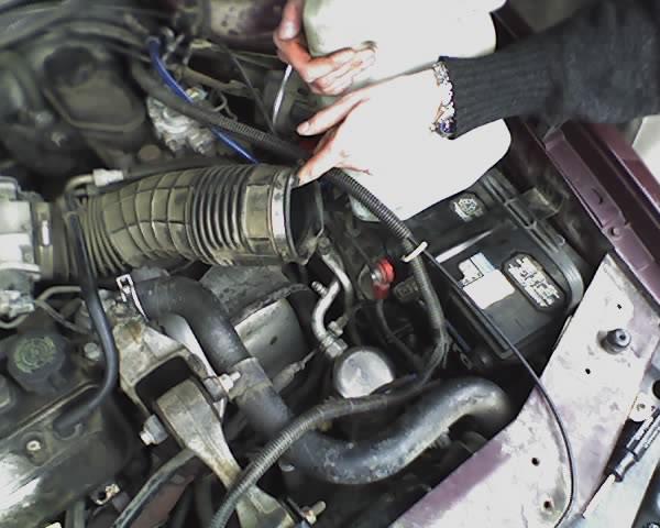

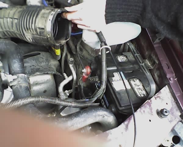

Silver Member Username: LewassBoomfield Hills, MI USA Post Number: 451 Registered: Jan-06 | I raised my idle rpms to ~900 and it helps a ton, so it seems like the problem was that with the new battery, the alternator actually had a constant load on it, rather than my old battery which had no reserve capacity and would show the alternator that it was fully charged very quickly. I think the alternator when running full blast makes the serpentine belt a lot harder to spin, and at 500 rpms my engine didn't have enough torque to keep up with it. So anyways It is now 90% better, I'm going to give it some time and see how it goes, and if it still has stalling issues I'll raise the rms up to 1050 or 1100... Thanks a lot for getting back to me with all my questions Isaac. Also, one more question for ya, I have my power wire ran to an auxilary battery post, I was thinking about attaching it directly to the top post on the battery itself, would this help a lot? The wire connecting the battery to the auxillary post is only a foot long, but looks like it is 8 gauge power wire.. I'll run outside and snap a picture. |

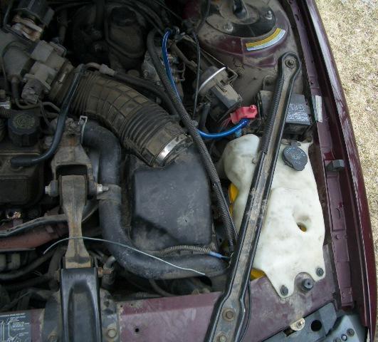

Silver Member Username: LewassBoomfield Hills, MI USA Post Number: 456 Registered: Jan-06 | Alternator is 105 amps stock. The car no longer stalls, and runs fine... now that I raised the throttle @ idle... Here are some better pictures showing the 4 gauge wire I'm using, and the ~8 gauge battery post I'm hooked to. I think I'll attach the power wire straight to the battery top post, what do you think?... ![]() |
Gold Member Username: CarguyPost Number: 5427 Registered: Nov-04 | Your power wires should always be connected directly to the battery via fuse. |
