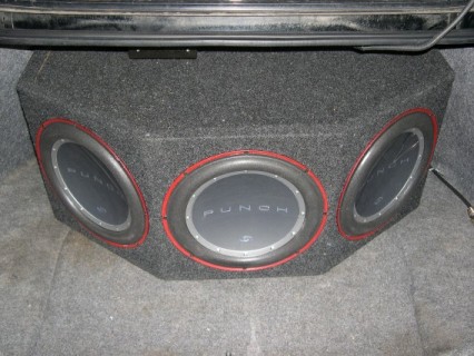

My last system I used 3 Fosgate punch 2 in a sealed enclosure, my single RE sx15" in a ported enclosure is much louder. Excursion also plays in this factor. Polo.. Upload

Username: Cenus
Hicksville, Ohio Usa
Post Number: 1497
Registered: Jan-05
nice weed wacker, you have there polo.
